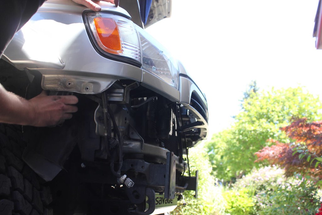

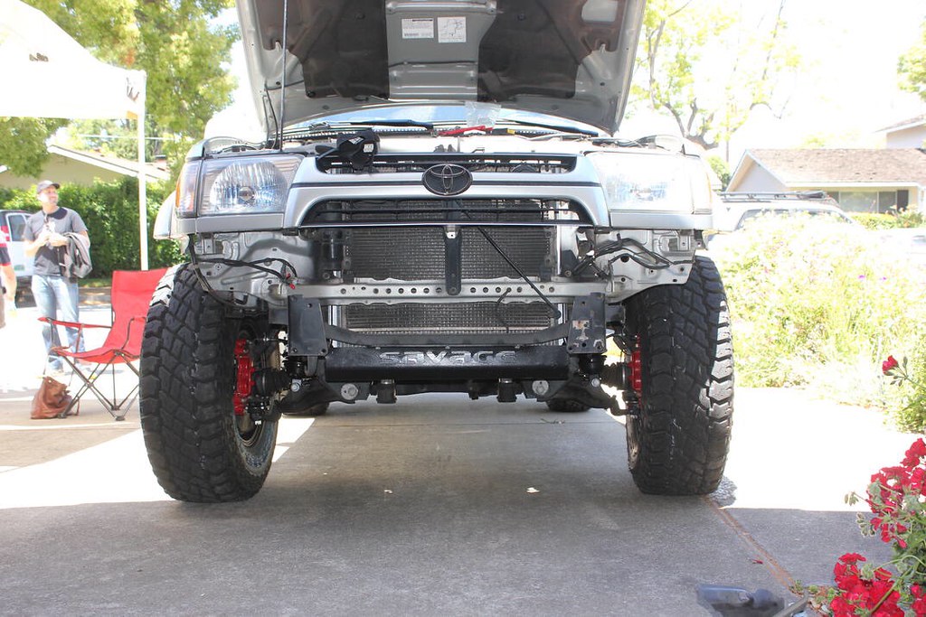

I'm pretty sure its the same on all the 3rd gens (for sure on '99-'02), but here is a picture showing the front mounting for the bumper. There are 6 bolts that mount to the front, and 1 on either side which can be partially seen in the picture.

You guys are great. Photos too!

The early ('96-'98) trucks don't have the impact cross beam on the front of the frame, just little caps, like so (my old rolled parts truck, one cap on, one cap off):
It didn't come with a bumper, but I believe the bumper is mostly held on with brackets that bolt on to the side of the frame rails next to the front body mount (still there in the above picture, just all bent up).

Right. Just 2 nuts for each bracket to Bumper, and 2 bolts for each bracket to frame. And I think 1 bolt on each end for fender liner to bumper. Takes no time to pull the bumper.
These early front bumpers are built like a cheese slice. Thin and incredibly flimsy. I was surprised when i had mine off. Was easily able to push a dent out using the jack and blocking. You might be able to bend things back into shape.
Edit: After looking at your photo, you might just be able to loosen the bracket to frame bolts and adjust the fit. There is quite a lot of slop in those holes so you can line things up just right before tightening. Good luck.

for further illustration and to answer the holes question (round, but you can judge by the hole in the square behind the one that it's bigger than the bolt needs)
here's a pic of the brackets (ignore the square bolted-on parts, yours won't have that). The horns bolt to the end of the frame rails.
and that's my husband's hairy arm chasing threads where one of the brackets bolt to.
