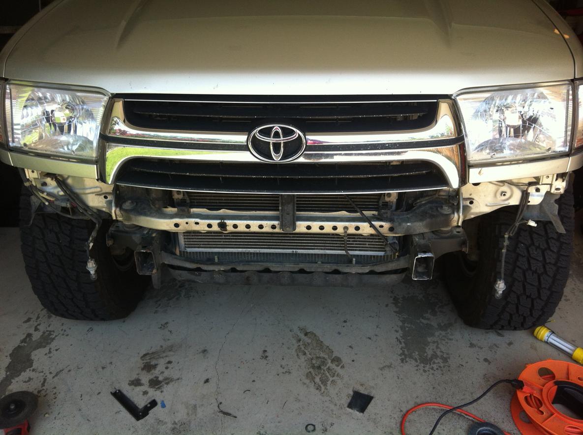

well hopefull it is just the bumper. There is a crash bare that runs between the 2 frame rails for support. There is also connections on each side of the bumper that help brace the sides. If all that is bent you might as well step up and buy an offroad bumper cause you are just going to cut all the stuff out anyway.
I hit a deer earlier this summer and the only thing that didn't move was the bumper crash bar (reinforcement bar), but it's hard to say w/o removing the bumper cover. If you just get down there an look from the bottom up, you'll know what's bent and should be able to judge based on how good you are with a BFH if you can bring it back to square...
I hit a 6-point buck and my bumper was flush with the headlight on the passenger side, but everything was fixed pretty easily (by me). So, yours shouldn't be too bad.
