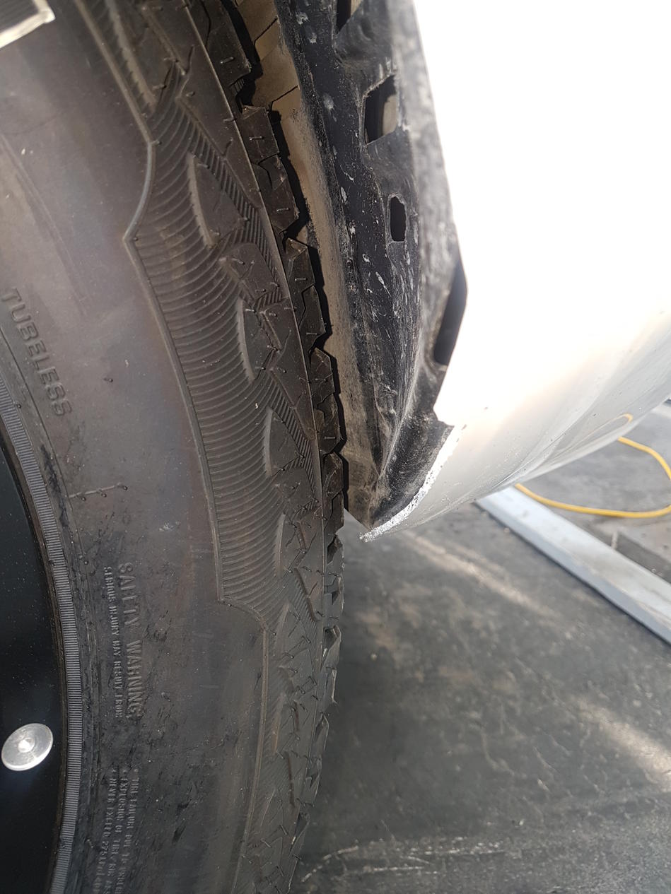

If you are running a negative offset like -10mm wheels @ 20x9 (which has a backspace of 4.5”) on stock height with a tire size of 275/55/20 10ply AT tire with 16/32 tread depth. You will rub on the bottom inner lip of the bumper, inner front fender liner, and front mud guards/mud flaps on a full turn lock or in reverse with a slight turn (how do I know this you ask? Because that was the result of what happened to me when I put this setup on my truck.
From what I saw, I am positive you can fit a 285/55/20 tire with backspacing of 4.5” or 5” if you do the bumper trimming and heat gun press and removal of mud flaps.

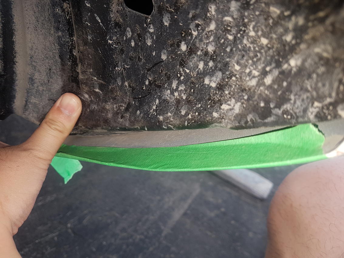

Step seven: Clean bumper inner lip with alcohol or damp soapy cloth

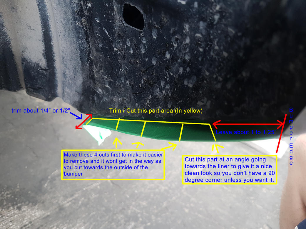

Step eight: Use painters tape and fold it in half to stick under the bumper and the other half over the upper half of the bumper (this will prevent any chip paint or harsh bumper damage from trimming it 1/4 “ - 1/2")

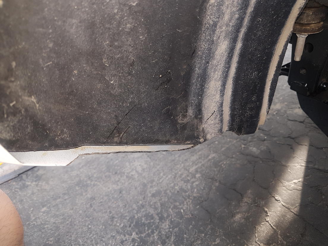

Step nine: Use the Dremel small cutting disc @ speed 2 or 3 and Make a few insert cuts towards the front to make it easier to remove the trimmed pieces when you cut horizontal towards outside the wheel well.
Step nine: Once you have trimmed out everything, use a Dremel sanding disc @ speed 2 to shave it even and remove any imperfections.

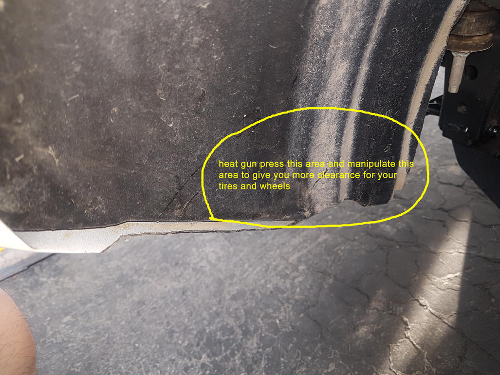

Step twelve: use your heat gun at level 1 or level 2 (if you run out of patience) and push the inner fender liner inwards by using either a needle nose plier or any other plier that can push on the fender liner.
Step thirteen: If you don’t want to see the black ABS plastic on your bumper where you trimmed. Use touch up paint to touch up the lip of the bumper.

Step fifteen: double check the clearance of the tires when turning left and right to see if you need to trim more depending if you want to have more clearance.
