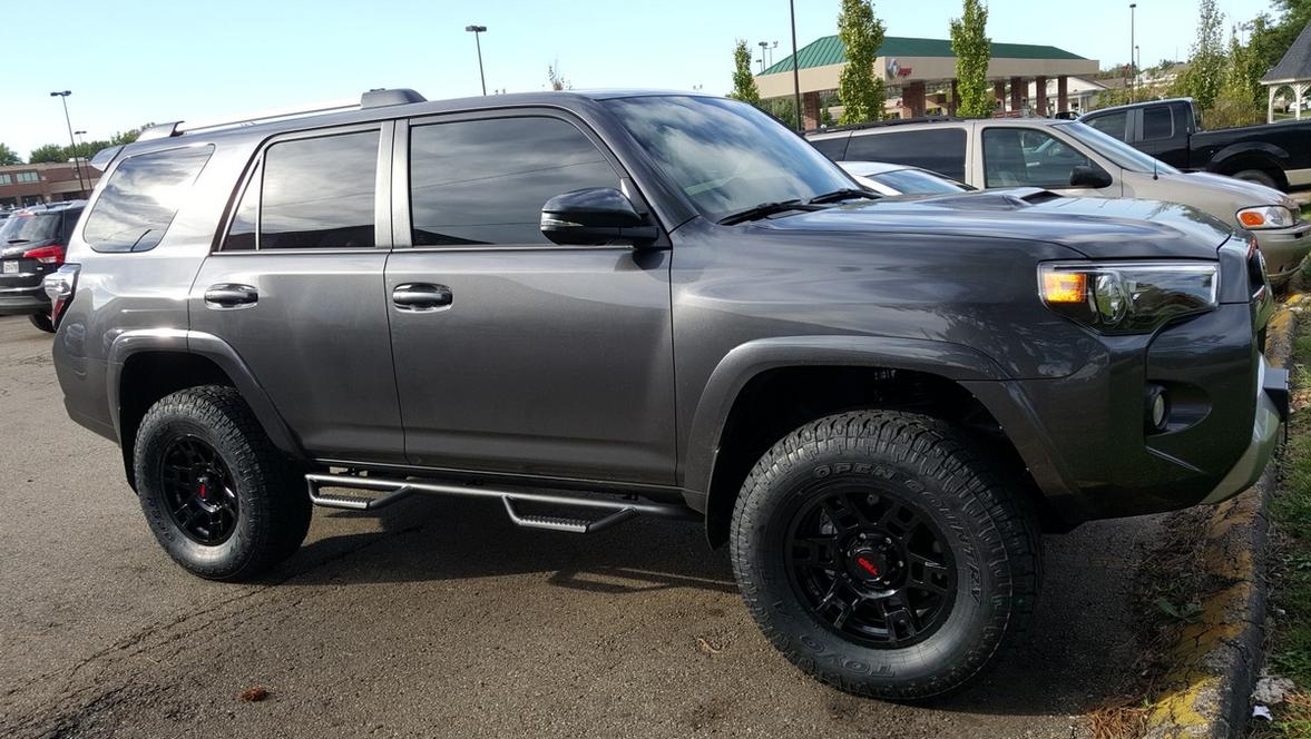

Hi, new guy here. Just got a 16 trail premium. So far, I have:
blacked out the windows
nfab nerf bars
weathertech mats
Next week:
1.75/3.5 bilstein 5100 lift
TRD black rims
285 Toyo tires
I am looking at a bumper and the one that appeals the most to me is the Metaltech. My question is, what is the purpose of the holes on each side of the license plate mount?

you will have to go 2.5 if you go 1.75 to be level. the picture is somewhat deceiving because of the factory fender cut outs, but it measures 1/4" higher in the rear using 2.5 and 1.75.
