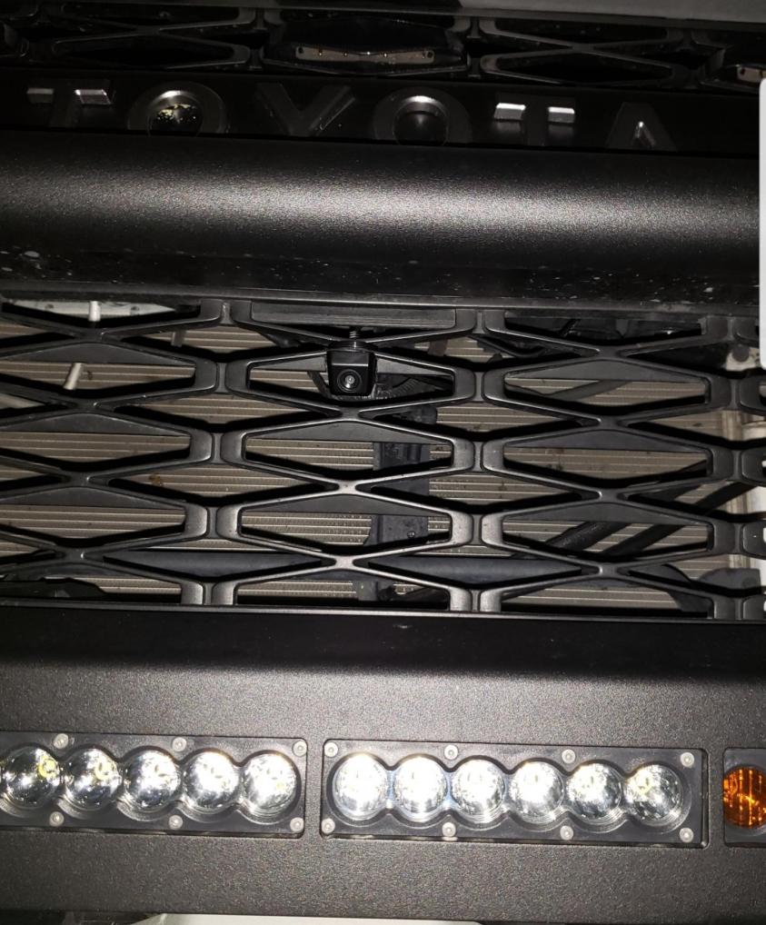

I have a C4 Lo Pro bumper with bull bar that covers the the camera. I just cut a notch on the grill the width of the camera, used VHB tape and a zip tie to secure it in to place. View from the camera is great. The quality of the video on the other hand, not so great.
