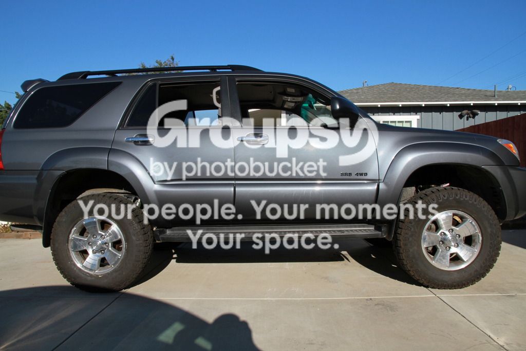

Plenty of people run this setup and there's a ton of pictures in the lift and tire thread. You shouldn't need the 10mm up front with an 885 coil, but you will likely need the 1.5 in the rear with the superflex for the driver side lean.
I don't have any recent pictures with me, but here was right after the lift. It has since settled down. I still need to take measurements.
