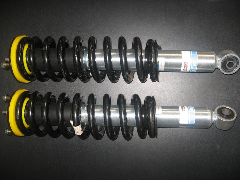

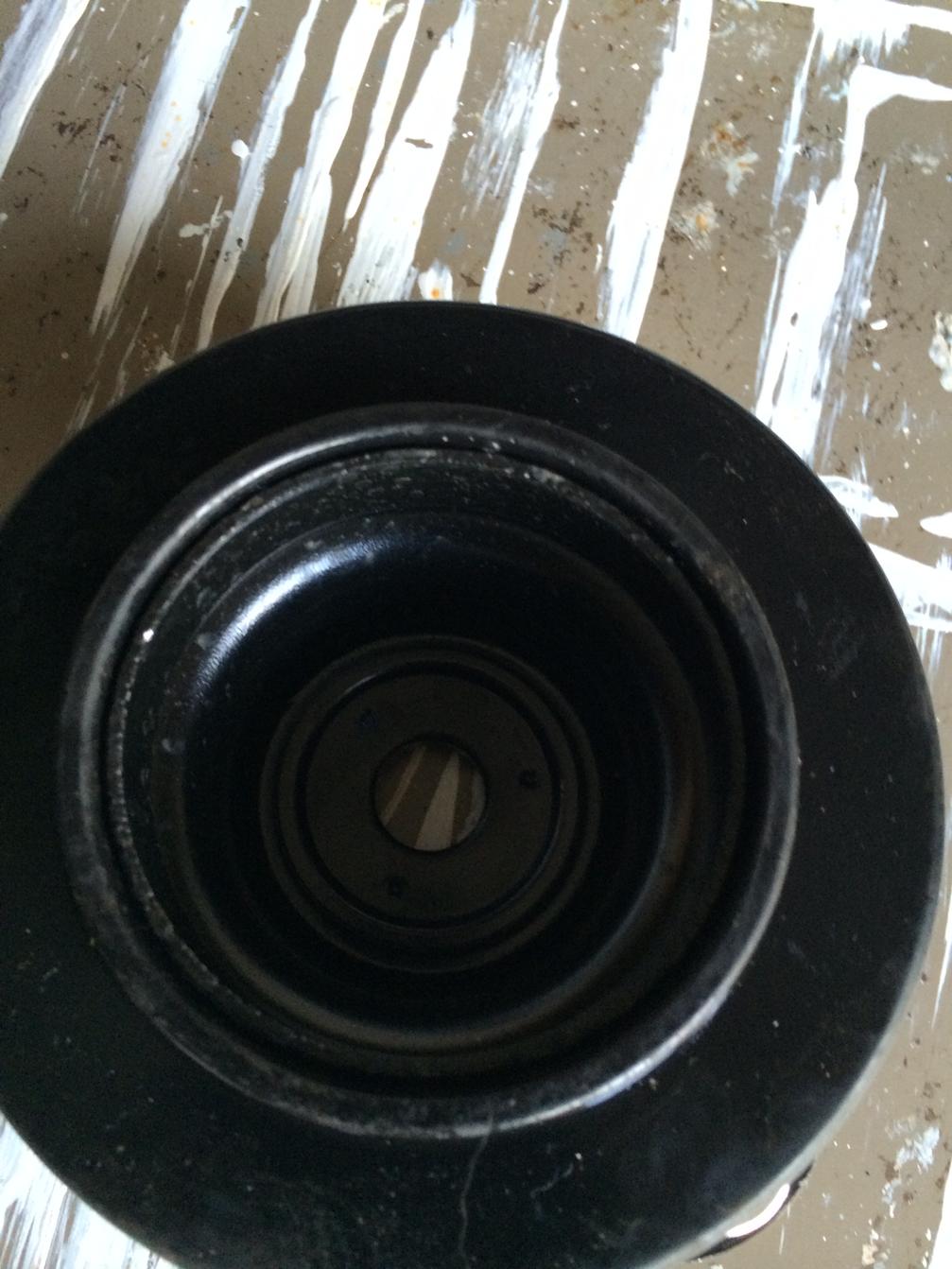

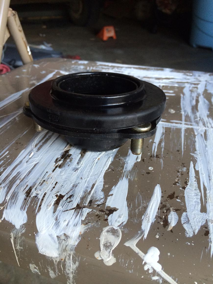

Success!!! Thank you very much for posting the sizes!! I ordered Energy Suspension Part# 9.6104 and as you can see in the pictures, it was a perfect fit! Not trimming needed, and from without having an isolator in there it raised it about an Inch. Didn't really notice how much noise they were making before, but its back to stock sounding, and feeling! and they were $13.00 from Autozone total for both sides!

Can someone confirm that these were being used for the front strut assembly to replace the rubber isolator or if this is something with the rear springs. I ask because the part number 9.6104G shows as being for the rear if I'm not mistaken.
So these would be going where the yellow is on the picture correct?
