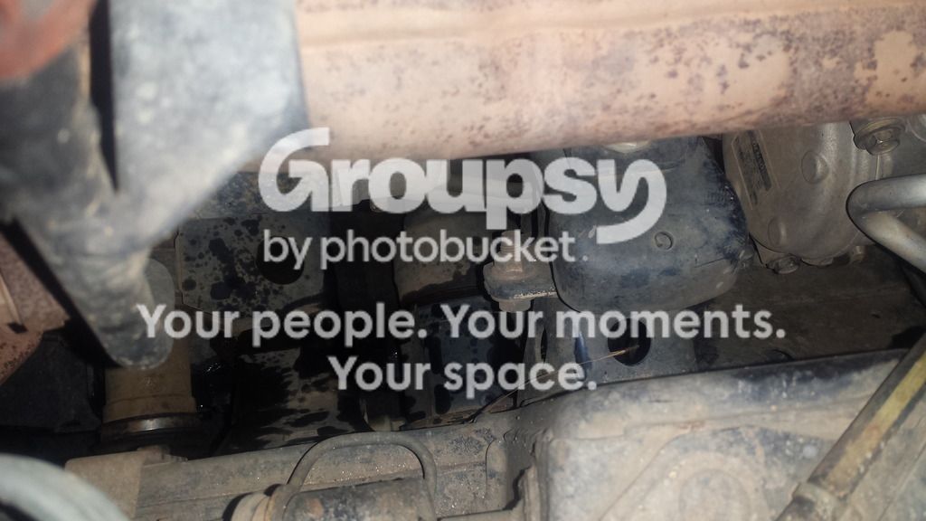

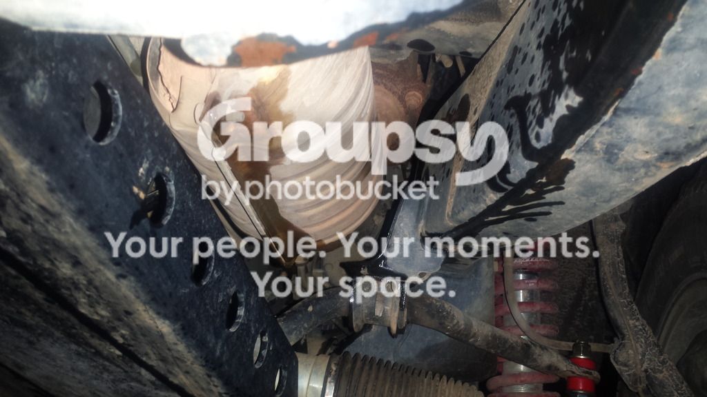

Hey everyone,
I got home late last night and smelled burning oil. Crawled under the truck and it's almost definitely the passenger side diff axle seal up front.
I've been reading about it and some people say it can leak due to debris being stuck in there? Is this true? I was on a dirt/gravel road this weekend and it was raining and kinda muddy. I looked at the breather this morning and it's still clean, but that's about as far into checking it as I got.
Any chance I can try cleaning it out with brake cleaner or would this cause more damage than good? The thing is since I was out there I drove 350 miles home and it started leaking somewhere along the way I guess. It wasn't leaking enough for me to notice at least when I changed out my front sway bar links sunday before I left. I feel like the damage has been done...
Toyota wants $555 to replace that seal that costs $26. What all tools would I need to do this myself? I have normal sized sockets and rachets, wrenches. I know I'd need a 35 or 36 mm socket for the axle nut. Not sure which size so I'll just get both. And a pry bar to get the CV out, and something to pull the old seal out with. Any suggestions for that? I have a fancy little seal puller that I used on the crank seal, but I don't have that with me here either...

I threw in some pics so you can see what you're working with...not sure how stuff would cause that to leak unless it got between seal and shaft or damaged seal...again, no expert.

It's definitley gear oil, it had that kinda clear not dark color that gear oil has unlike all the other fluids up there like the motor oil, and transmission fluid (power steering in mine is ATF as well). It had that gear oil smell too.
What was the one that you dealt with that wasn't small like? Was there oil run all the way down the truck kinda like mine? I'm sure mine was slightly exaggerated from the 5 hours of 70 MPH that I had just driven too.
I haven't checked the fluid level, but I can't think of what else it would be. I'm thinking I may have had a slow leak there that wouldn't drip or sling like it is now, and I didn't notice until now because of my aftermarket skids.

I'm thinking it ran down the frame the way it did because of how the CV's turn when going forwards it would throw the grease back and up therefore allowing it to run down the exhaust and cat as well as the frame like it did in my pictures. I'm thinking tomorrow I may pull my skids and check the fluid level, but I don't know if it's leaked enough to notice a difference in the fluid level yet.

It was definitely oily, you can smell it burning too after driving. I'm about 99% that it's that seal. The skids have a good bit of oil slung right under the CV and behind it with nothing in front, or above the CV either.
