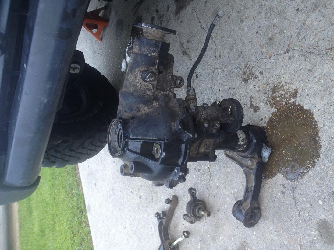

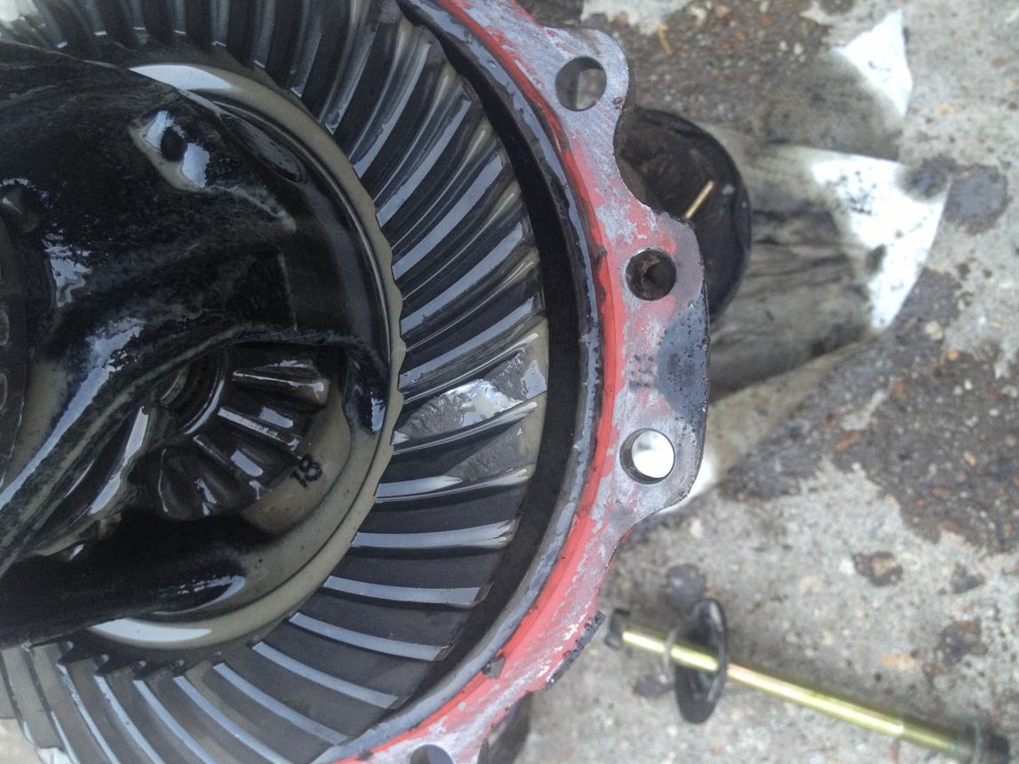

Well I thought I was going to be able to replace the needle bearings. After removing the diff the afternoon I found that now only were the bearings completely tore up from the axle shaft breaking there is also two teeth sheared off of the ring gear so looks like I'm going to be putting in a used diff. Any advice on how to go about finding out what gear ratio I have?
Here's a pic of the damage.

Wonder how you managed to chip a tooth. I've done some pretty hard wheeling and never done it (knock on wood) so you must have had some issues going on in there.
^^ what he said.. Divide the number of teeth on the ring gear by number of teeth on pinion.

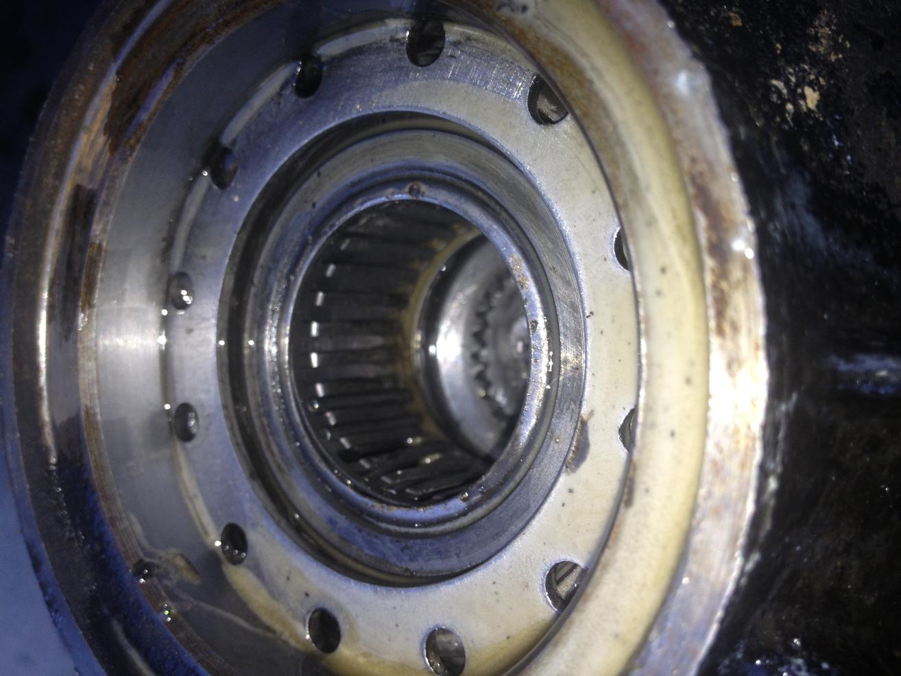

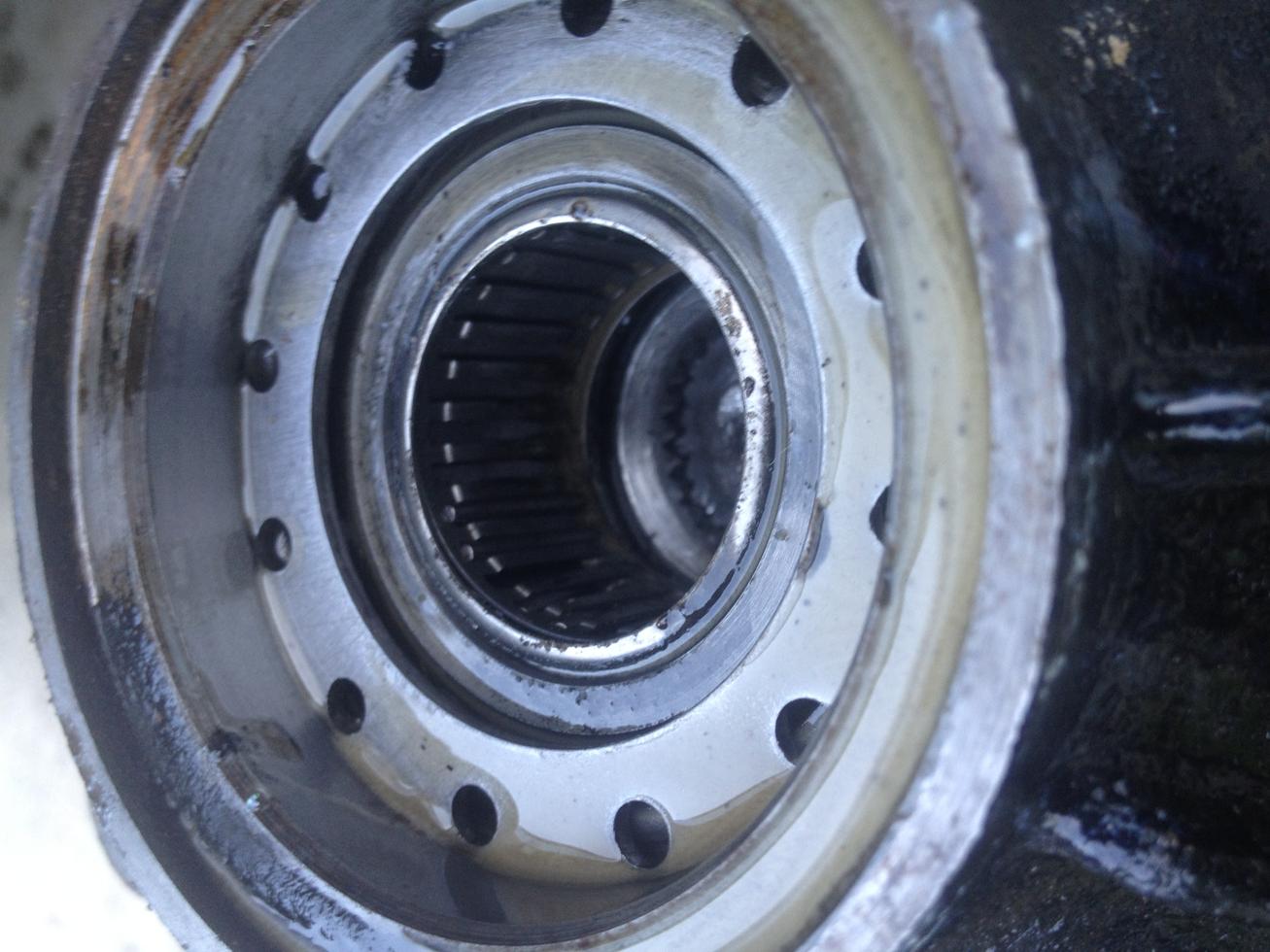

Yea i was very surprised to see that the teeth were broken myself. It started out as an axle shaft sheared in half inside the diff. The only thing i can think is that the needle bearings got wedged in the ring and pinion thus creating catastrophic failure:happens:
