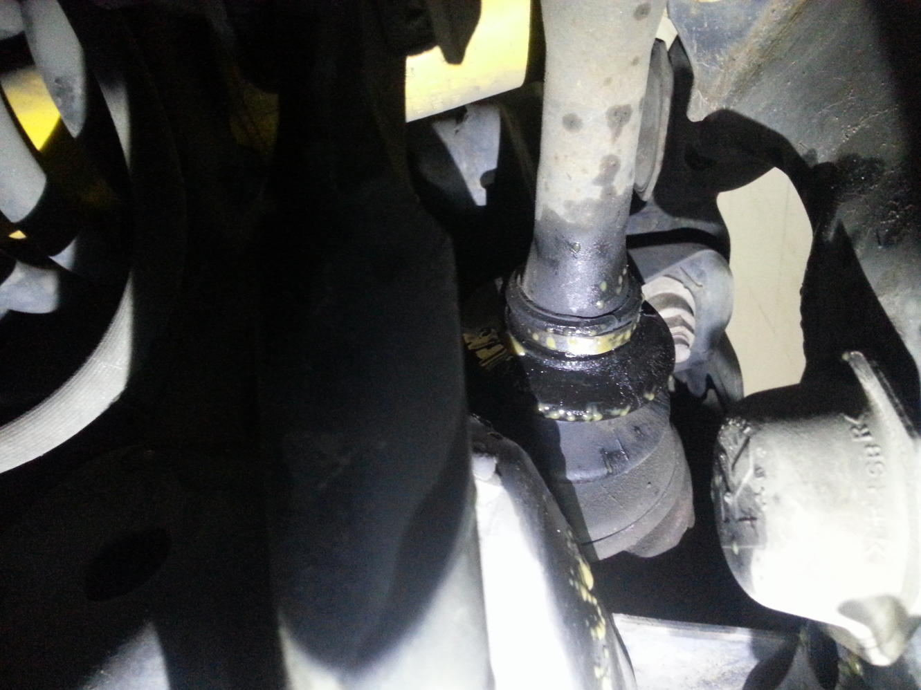

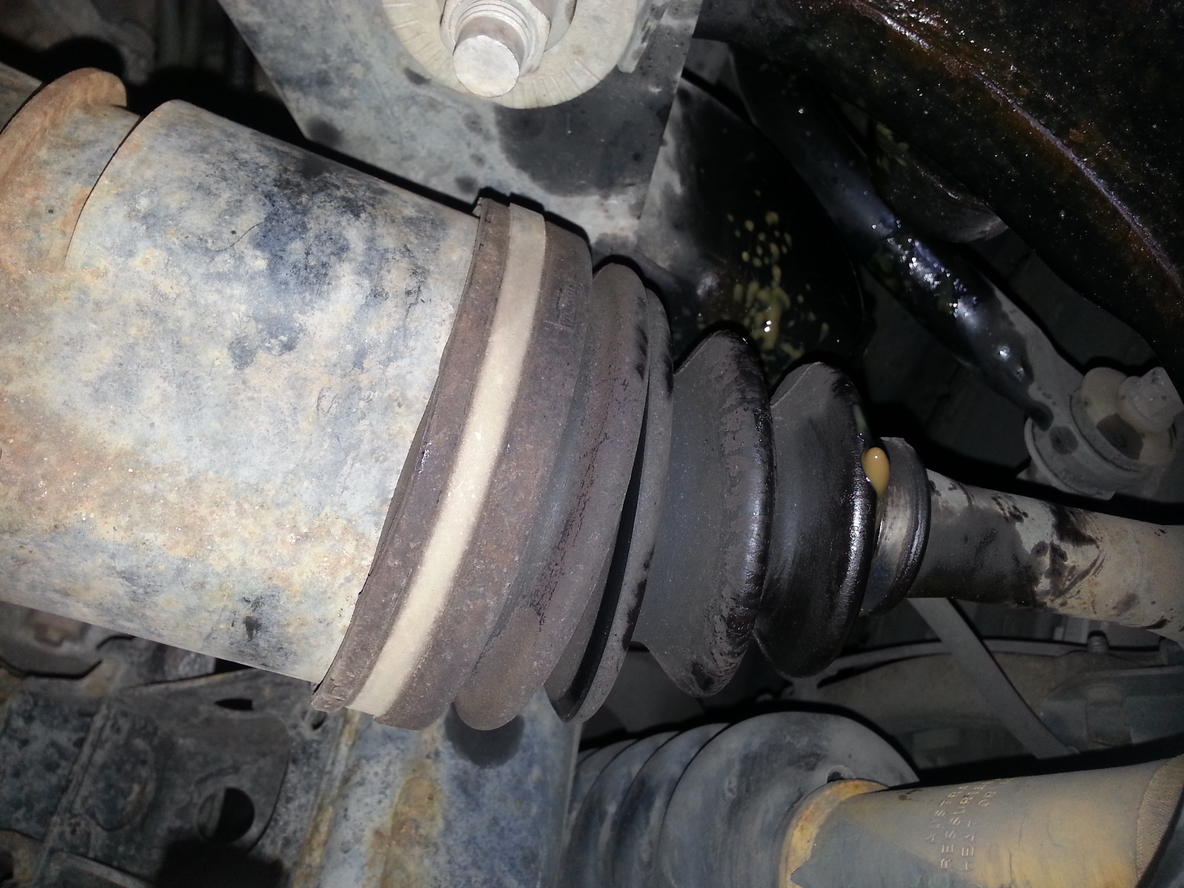

found a small puddle of thin grease leaking under RT front driveshaft, passenger side inner boot yesterday morning and found a tear in boot today. Is there just a boot kit for this? With the leakage would I be better off replacing drive shaft? I have no clue what is in this area as I'm no mechanic so I assume if grease it is contaminated if that is what I am seeing actually dripping out. How hard to replace the entire shaft? cost if anyone knows. I am stationed in Europe currently and don't have access to another vehicle, is this still driveable for awhile as is? Sorry for all the questions, trying to figure out what to do asap as it takes a bit to get parts over here. 20171115_053558.jpg

That is probably just fine to re-boot. And drive for a while like that (a couple guys have been driving for years on ripped boots).
OEM boot kits should be available at the dealer.
Inner only boot kit: 04438-35040
Inner and outer boot kit: 04438-35030
Each of those is good for one axle (a single inner boot or an inner and outer boot pair).
-Charlie
