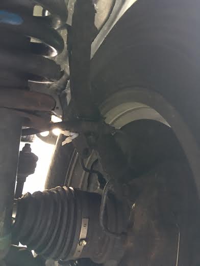

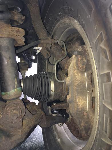

I had a similar rattle/noise and it turned out to be this clip or spacer or something. The bolt was sheared off on one side, missing on the other. I used a couple of zip ties and no more rattle!
Hey just looking at your pic, i dont see which clip.spacer your talking about? abotu to check this out, since ihve had this same problem for a while now
Here's a pic with the flash, it's right there where you see the 2 white zip ties. I think it's a spacer for the brake line?
