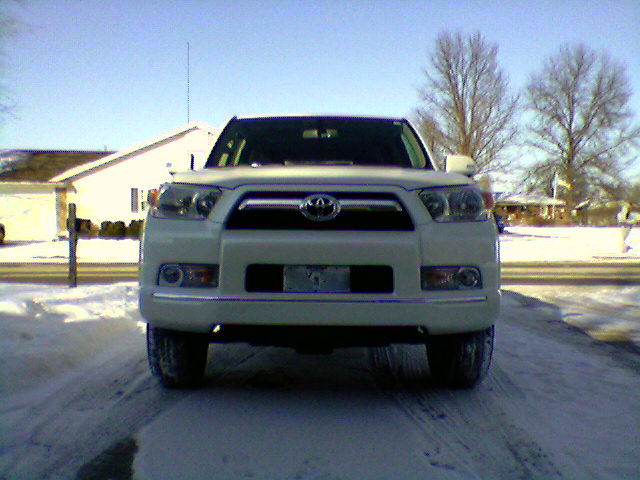

Me and my wife just got a 2010 SR5 4runner 4x4 Blizzard White last week and so far we love it. I'm wanting to put a license plate on the front but I don't like where they have the two pre drilled spots its way to high up almost in the grille. I want to mount a bracket down lower on the next plastic spoiler area under the air intake area. I went to several part dealers and haven't found any decent looking brackets has anybody does this yet or know what kind of plastic bracket has a flat flush back on it? I know I will have to screw or bolt into the plastic spoiler.
If there are accessible bolts on the underside/backside of the front bumper (like where the black cross-hatched portion may mount to the bumper?), one option would be to fabricate a bracket out of 1/2" aluminum flat stock that you should be able to find at an hardware store or home building center. I'll have to crawl under there tomorrow and see if there are any mounting points under there. It won't do me much good as my dealer had already mounted a frame to the front bumper when I picked up my car, but it might help some others out.
I want to find bracket like shown for the Accord that is thin and flat but I want of mount it right below where the Missouri license plate is, where the chrome strip and the next white section about 10" tall is.

I think the guy from Missouri must have trimmed his plate. Mine does not fit in the gap at all.

I took my car to a friend of my dad's who does auto detailing, accessories, etc.. I told him my dilemma with mounting the license plate and he gave me two solutions, 1) drill into the bumper or 2) mount it in the bottom part of the grille. He also mentioned that he would not drill into the bumper if it were his car. Anyways, the license plate is not cut, it's bent backward, so that the edge is rounded. He popped the hood and secured it in place with two screws with bolts in the back - but I'm sure you could use zip ties.
Never thought about bending a license plate to be illegal, but oh well, I'm just missing the bottom inch or inch and a half which has nothing on it anyways. From the way I see it, I accomplished what I wanted to which was to have a front license plate and not drill into the bumper.

Thanks for getting back to us. I was looking at my front plate and the bottom grille today and I think that the number and letter part of CA plates are taller than on MO. To make it fit, I would have to bend (or cut off) part of the letters on my plate.

I did check whether I can bend my plate to fit and the damn letters are too tall. Missouri must use smaller type font on the actual alphanumeric type.
My SR5 had two dimples on the front bumper where you can self tap a plate bracket onto. I used an awl to start the holes and then just screwed on the bracket, screwed the plate onto the bracket with a Toyota plate frame, took me all of 5 minutes. I must admit it didn't look as bad as I thought it would.
That may ultimately be what I end up doing. Although I'm also considering purchasing a Skene license plate bracket and then mounting it to the lower grill by using washers and a longer bolt through the grill openings. I imagine over time it may scratch up the honeycomb grill insert but at least I won't have any holes in my bumper.
There are already two holes in your front bumper, they're just covered in a thin shield of plastic. You can actually use a bolt to put you bracket on as the hole comes out on the inside of the bumper.
