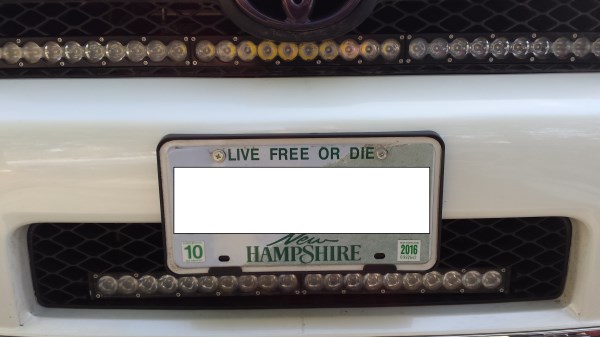

You can build your own brackets. They're not quite as cost effective as buying the Skene mount, but they look better and they're pretty damn solid.

That's right. I figured 4 holes in the bottom/angled part of the lower bumper were better than 2 holes in the front of the upper bumper, not to mention my preference to have the plate down lower.
The decision was easier with the trail and the black plastic than it may have been if I was drilling 4 fresh holes through paint though.
I'm happy to walk through what I did if you're interested. It's not the quickest solution, or necessarily the most cost effective depending on how you value your time, but it was a nice little project with a relatively satisfying result.
Looks slick man, nice and stealth. But I would have ripped that off already. mmmmmm mud....

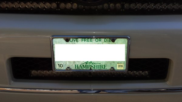

I was very angry to find my brand new 4 runner with two holes in it. What i did was bend the plate at the bottom. Just below the numbers. I used two two inch bolts with a washer. it looks good. Toyota did not think this our very well. I have a 04 runner and favor her more than 2010.

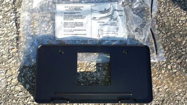

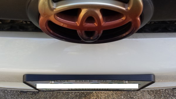

I realize this is an old thread, but thought I'd offer an OEM option (2010-2013) for those who are required to have a front plate. Last week I came across a 2015 Sienna plate bracket that looked like it would fit, after matching it up to the bumper, contour was almost perfect.
OEM Toyota part.......................
BRACKET, FRONT LICENSE PLATE.
BRACKET SUB-ASSY, FR
Stock Code 7510108010 $35.66 (online prices ranged from $5 - $40)
Started with plate and plate frame mounted to bumper, remove with 10mm socket or Phillips screwdriver.

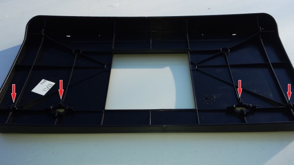

Only modification needed, trim tabs (red arrows) flush with ribs to allow bracket to sit flush when mounted to bumper. Tabs can easily be trimmed with a razor knife or grinder.

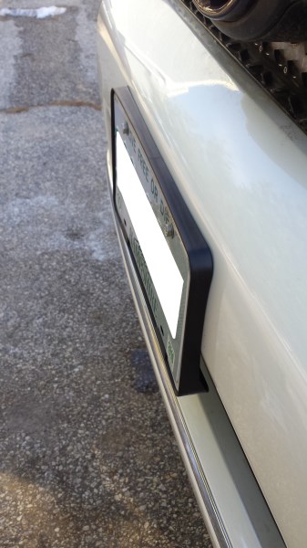

Insert plate into bracket, reattach to bumper with supplied screws.
