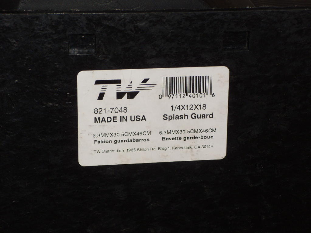

821-7048 is the product number, I have attached a picture I think...
$7.99 each. Triple A member? Show your card and save 10%.

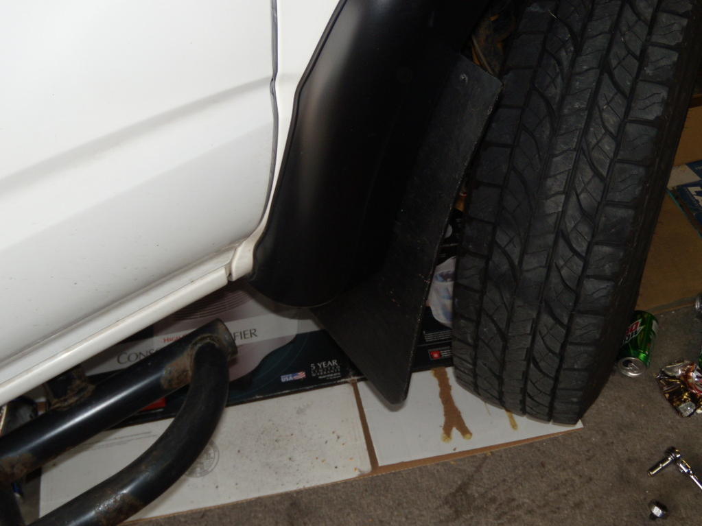

The TW splash guard comes with 4 cut outs perforated at the top, so that made locating the top screw just a matter of deciding how much material I wanted to stick out past the fender flare. You can see one of the cutouts in the last photo.

You'll notice from the dimensions of the TW splash guard that it is a full 1/4 inch thick. If I get around to it I may look for slightly longer M6 screws to replace the OEMs for a bit more grip atop the rubber.

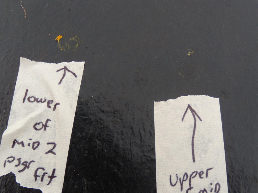

I then determined the location of to the bottom screw by backing out the threads of it a bit and using a rubber mallet to pound around the screw head-this left enough of a dimple that I could remove the top screw, and drill out the bottom hole.
I repeated the process for the middle 2 screws, I used a yellow wax pencil to coat the screw heads and dimpled them with the mallet, removed top and bottom screws and then drilled out the middle 2 holes.
I have about 2 and 1/8 inches of additional coverage now outside the Bushwacker Extend a Fender flares-and about 5.25 inches of coverage from the bottom of the wheel well.
