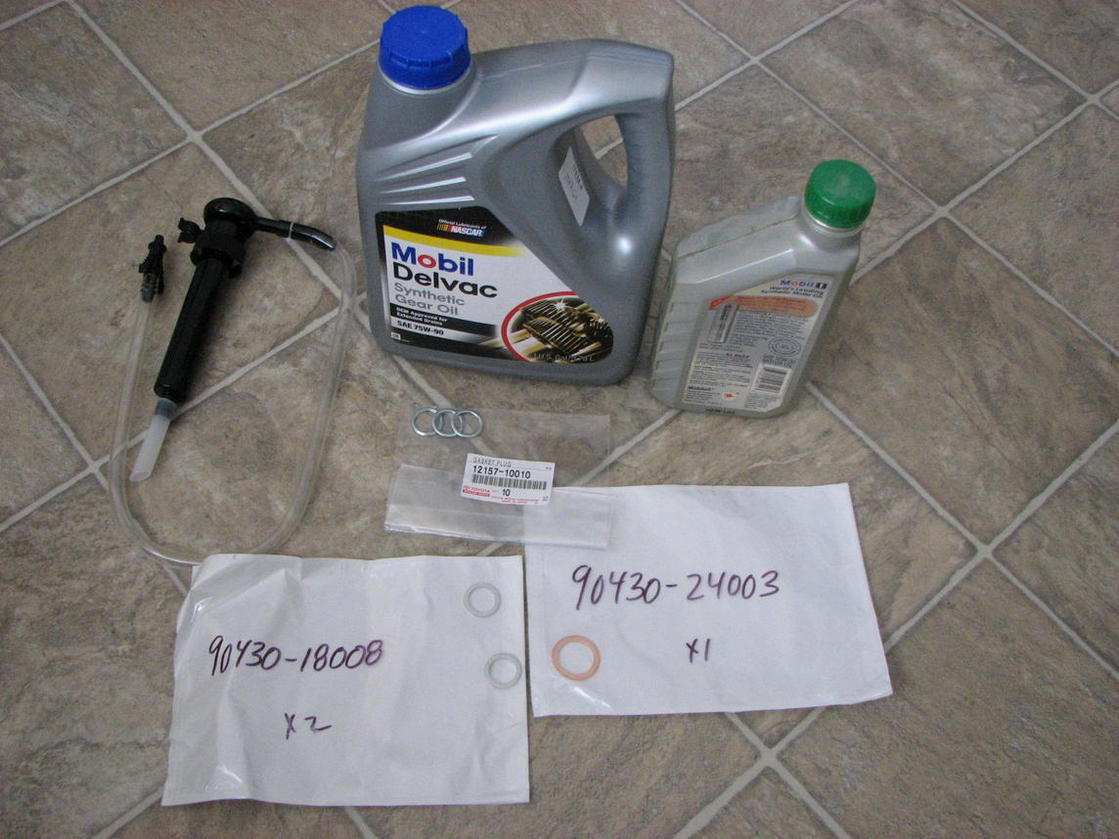

My choice is Delvac.
Popular on the FJ forums and vintage Porsche transaxles.
repost of my opinion from one of the other T/C Diff threads...
"These things don't break. I'd be willing to bet most dealers use whatever is the cheapest bulk gear oil that their petroleum rep carries.
My dealer wouldn't even order the spec'd Toyota product and in the end I'm glad I didn't waste the money.
All of the ones you mentioned will be fine. I went with Delvac from Zoro tools for t/c and f/r diffs due to no LS additive.
If I were to get another 4R today I wouldn't bother changing the t/c or front diff for at least 75-90k miles."
