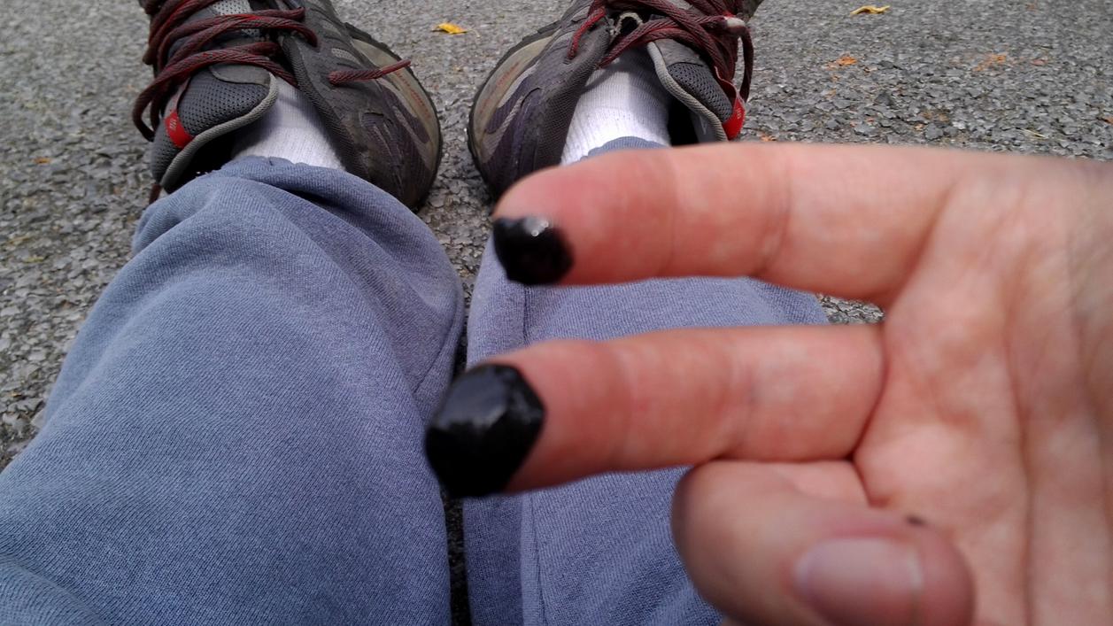

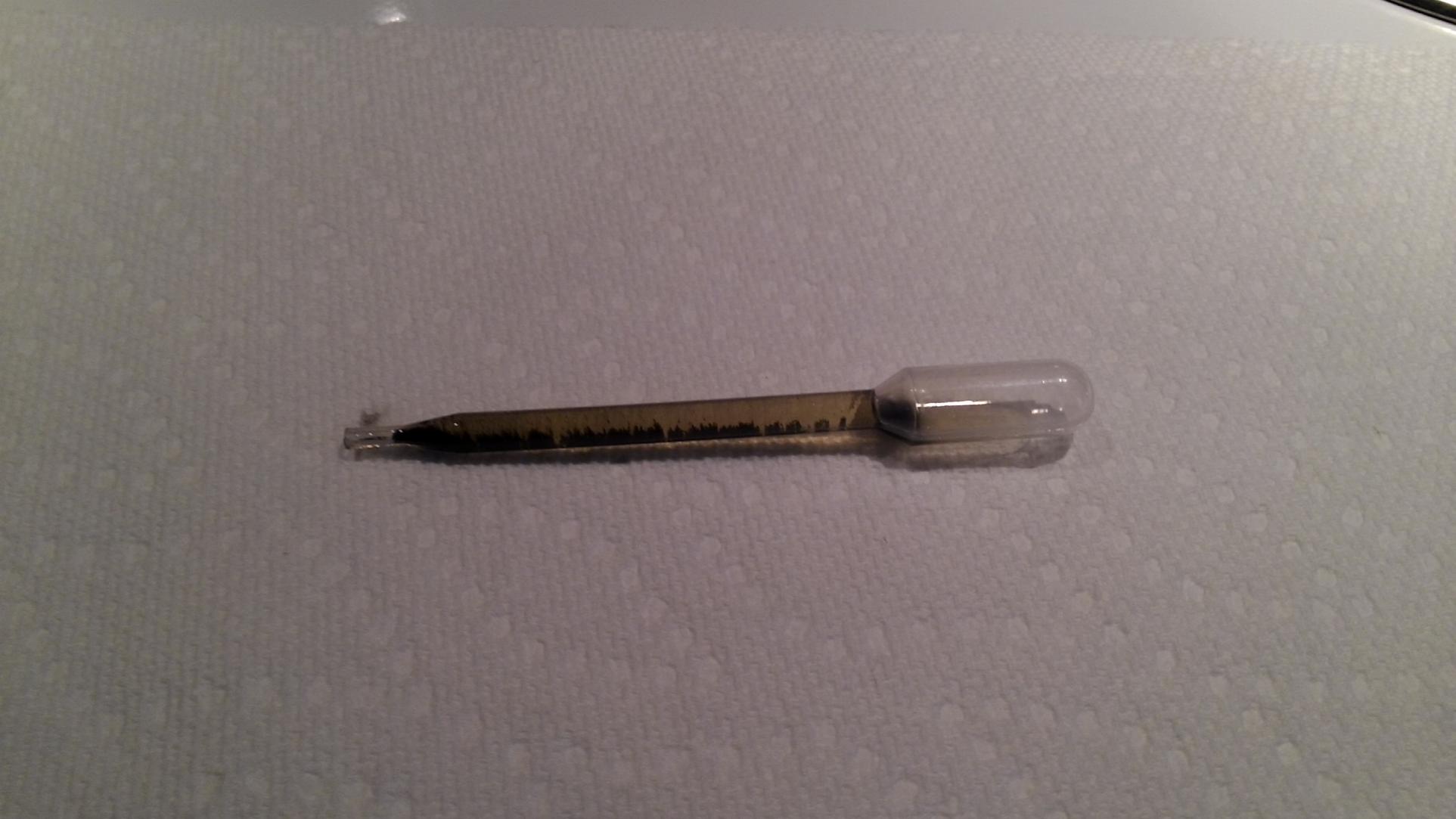

After letting my oil sample set for two days the sediment settled out and the oil turned clear. I squirted some onto my finger and the sediment is very fine, barely able to feel it. I'm still changing it though. Dealer said that the trucks come stock with synthetic diff oil in them and that you can go from regular oil to synthetic but not vice versa. I've called distributors within 50 miles of me and no one carries Amsoil so I'll buy online and drive easy until it gets changed.

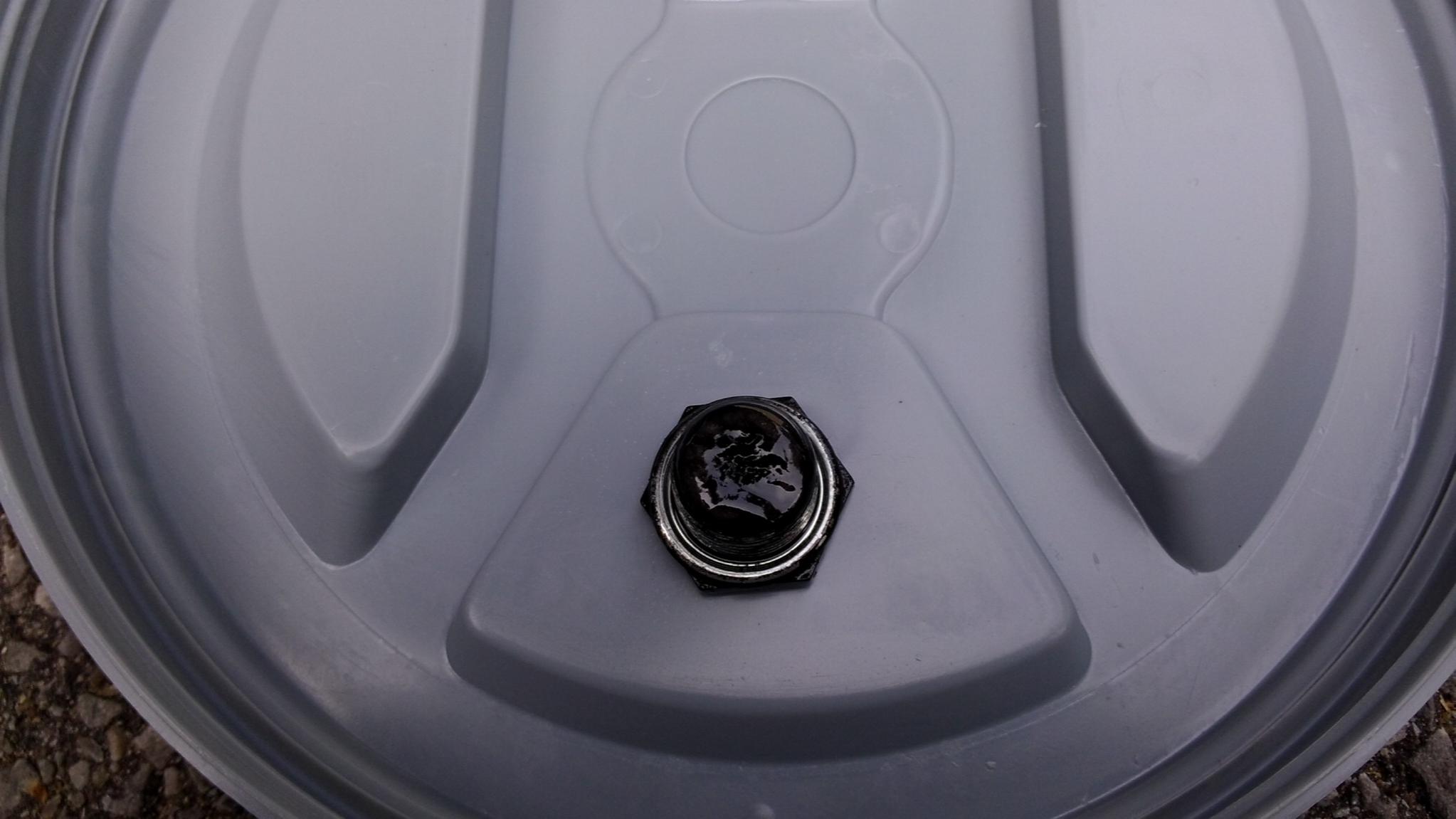

Changed the oil today. This is what the magnet had on it after 5000 miles. I'm done hogging the thread now. Thanks for all of your input.

I am glad I saw this thread...it motivated me to change my rear diff fluid this morning and boy am I glad I did. I'm at ~13,000 miles and after seeing my magnet and the black (sort of milky) oil that came out, I wish I had done it earlier.
Used Mobil 1 75w90 synthetic.
Thanks again forum!
