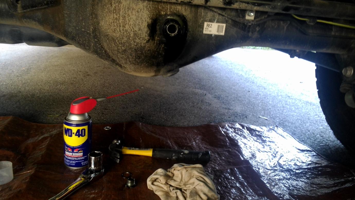

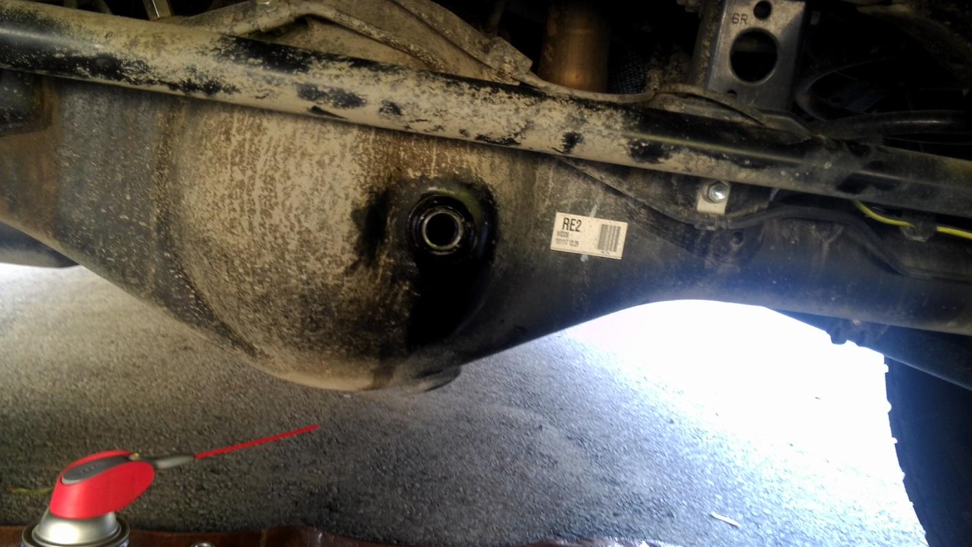

VICTORY ! Sprayed WD40 on it yesterday and today, tapped on it with a hammer and put a larger 1/2 " ratchet with a 6 point 15/16" socket on it. Pulled down with everything I had (and I weigh 200 lbs) but no movement. I feared rounding the bolt head so went in and had lunch. Later I tried again, more WD40 and tapping, I put the ratchet on to push up and it gave. I thought, Shit I've rounded the head but tried again and it came right out with no damage.

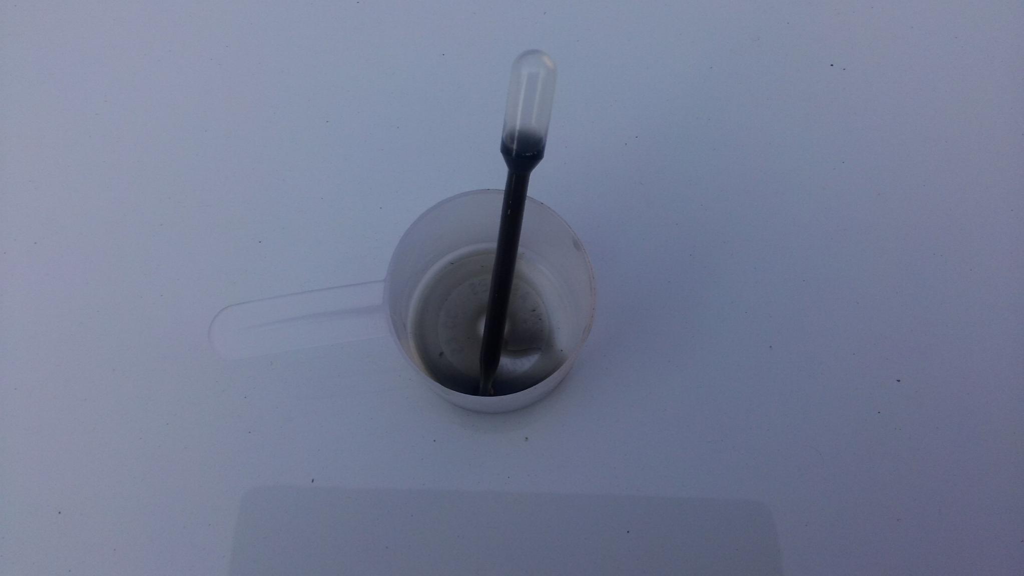

So put a little dropper in and sucked up some juice and as you will see, it is as black as my soul. It still feels slick but I'm guessing it ain't good if it looks like that! My truck is 6 months old with 4941 miles on it. So when the dealer is open I'll get some oil and change it out. Hopefully the drain plug will come out easier.

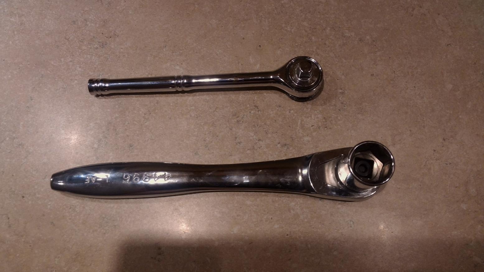

In the bottom pic,I'm guessing size does matter.
the gear oil being black at your mileage may mean you drove it too hard the first 500 miles and or you drove it for too long of a drive during this period. the gear teeth need about 500 or so miles to break in during this period the gear oil gets hot so short drives are recommended and also no load/towing hard driving etc.
good you checked it .. I would recheck this after a 2k miles .
