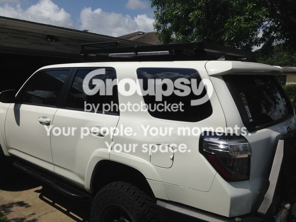

The table works perfectly on the standard rack and extended rack if mounted on the sides. On the full length you would have to position the legs high enough and far enough apart to mount it under neath. I originally looked at installing my table above the rear but the latch mechanism would contact the rear spoiler and the shark fin will keep the table from going in as well. I have had this setup for about two years with zero problems. I would recommend that you take some felt or rubber pads and place them between the legs and the table bottom where they fold up. I did this so I didn't have to hear them rattle going down the trail. Below is a pic of the large table mounted on the rack. Having quick access to a large table comes in super handy when camping.

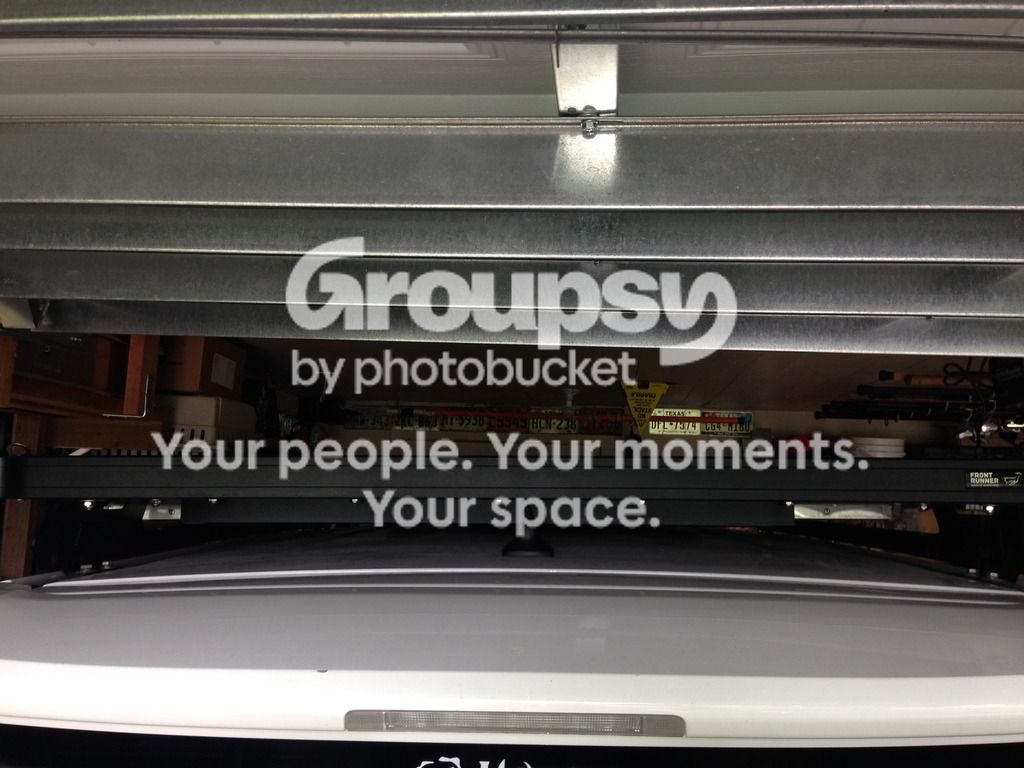

Here are a few more pics of the table mounts.
This is shot from the back so you can see how the storage slides hold the table up. I would mount the slides and fit the the table before the rack goes onto the truck for ease of installation and it allows you to really snug up the table for zero rattles.

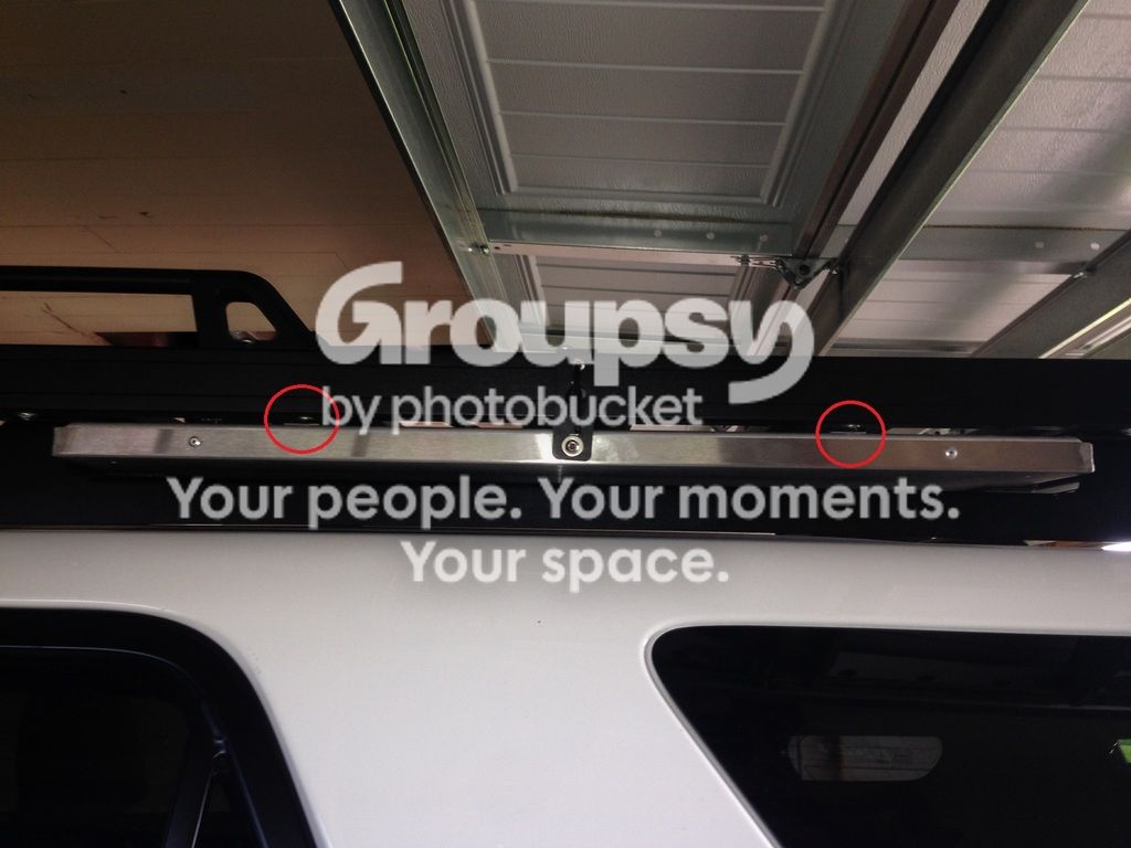

Here is a pic from the side the two red circles are where I placed Velcro on the table since it rides against the bolt heads. This keeps the table from rattling and makes for a tight fit. You can also see the locking latch that allows you to put a small lock to keep someone from getting a nice stainless table..

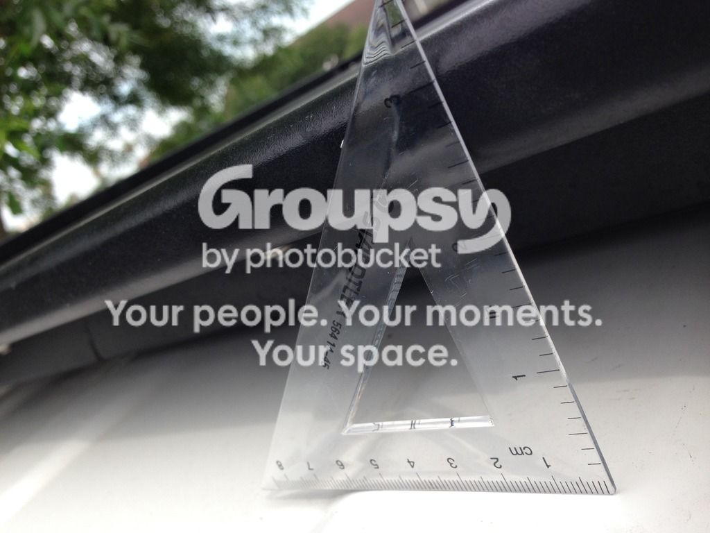

[MENTION=110414]Taco04[/MENTION] can you measure the what the minimum space that would be needed for this? From lower edge of rack to lowest point on table slide? I want to see if it will fit mine with 40mm mounting feet. Thanks
Gabe, I took a look at it this morning and the lowest point of the slide to the roof is at the front of the truck where the roof has the ridges. I used a triangle and wedged it in and marked it and it came out to 5/8" from the bottom of the slide to the top of the roof. At the same point the bottom of the roof rack is approximately 2-3/8" from the ridge as well. This point is 43" from where the hatch meets the roof to the front of the slide. The reason I included this measurement is because the roof looks to have a bit of a curve so these measurements might change some depending on how far forward or back the slides are mounted. Below is a pic from where I measured so you can use it as a reference. Hope this helps
