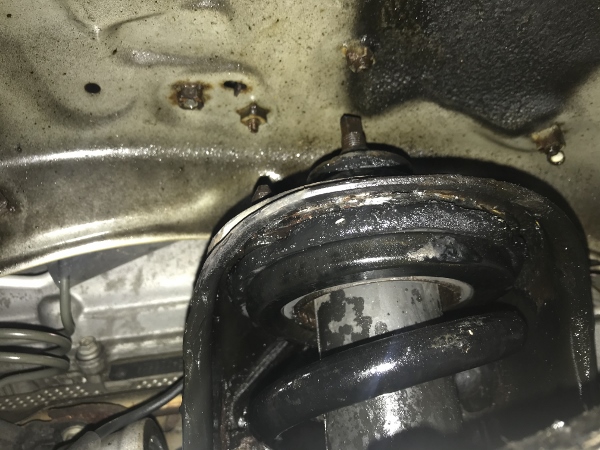

Installing new struts and springs in all 4 corners and the factory drivers side front strut is completely stuck. Passenger side was ok getting out, rear two struts required sawzall. Have tried PB blaster, torch and sawzall with no success.
Already pulled xreas so rolling it to a shop will be tough. Does anyone have any advice?

no need for a sawzall or cutting torch, the body of the shock is stuck in the hole of the shock tower... get a long beefy crow bar or pry bar & wedge it in between one of the top spring coils & the inside of that shock tower, then pry side to side & downward with as much force as you can manage to dislodge it, it should pop out. also try to hit the top of the shock & the 3 bolts with a hammer to help break it free. & make sure the lower control arm is pushed down & not touching the bottom of the shock helping to keep it in there.
if you havent, use some penetrating oil around that whole area to help & if it still doesnt come out try some heat on the outer area of the shock tower hole, not on the shock itself. i suggest a propane torch as the flame is smaller & not as hot so no risk of damaging other parts or catching the vehicle on fire! ;)
but you shouldn't need heat, prying in the right area with the right angle & amount of force it will come out, its just light rust/corrosion holding it in there & its not seized or welded in place from the rust.

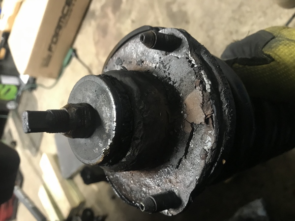

Still stuck after hours of torching, burning, chiseling, and beating:
doctorpopcorn-albums--05-v8-sport-lift-and-xreas-replacement-picture60176-beating-ensued-trying-separate-top-hat-strut-tower.jpg

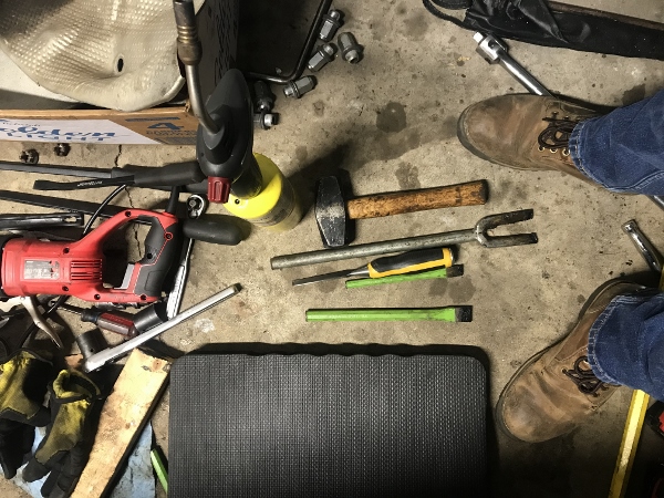

Surgical equipment used (just skip straight to the wood chisel):
doctorpopcorn-albums--05-v8-sport-lift-and-xreas-replacement-picture60177-tool-collection-used-surgery.jpg
The demented top hat that tormented & taunted me for days:
doctorpopcorn-albums--05-v8-sport-lift-and-xreas-replacement-picture60179-top-rust-welded-top-hat-taking-good-amount-paint.jpg
