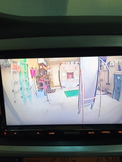

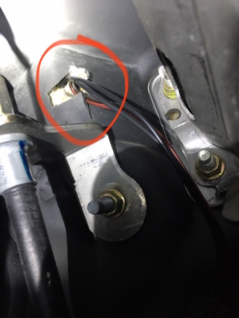

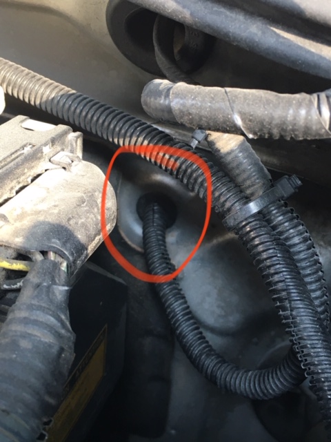

[MENTION=50507]CookieRoe[/MENTION] I had an audio shop install my front facing camera. I went out and took a look at how they ran the wires from the head unit to the engine bay. It looks like they either drilled a hole through or used an existing hole to gain access to the engine bay. I had to replace the 1st camera after it died. Here are the pics. The wires run through the drivers side and come out close by the brake fluid reservoir. I have a Kenwood head unit that accepts two video inputs for a front cam and reverse cam. I also have a Nakita cam that I bought on amazon. It works great.

Besides the passenger side grommet (Haven't tried it yet), is there another way into the cabin? All I have to do is run one video cable (and small power wire). From what I've read the driver's side grommets are a massive pain in the ass.

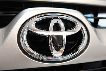

Regarding the logo camera, eff that, I got a Nikita camera from Amazon. Going to mount it in the front bumper. It will be an "anytime" camera. So, why abandon the logo cam?
1) Not one of them fit. I've collected a few over the years
2) They are cheap, got them from AliExpress. (reliability is crap)
3) I'd rather not dremel and mod the front logo.
I used the drivers side grommet for wiring for my lights, really wasn't that bad at all, actually probably one of the easier firewall passthroughs I've used on any vehicle.
Any thought if the larger 06-09 grille logo would work with any of these cameras? I noticed while working on swapping my grille that the 06-09 logo is quite a bit bigger, so maybe one of these cameras might work with that logo?
This will be my second Nakita camera. My camera's (from aliexpress and some cheap ones from fleabay) kept dying on me. The Nakita has lasted so far. Thanks for sharing the pictures, it is very helpful!
I gave up after ordering 3 cameras and none of them fit. This was 4-5 years ago and decided to get a quality (Nakita) camera. As far as getting a logo camera to fit, MAYBE, but I'm iffy on the quality of them. Changing out a camera is easy (depending on how you wire them), but honestly I'd rather no deal with constantly going back to a mod to fix it.

I also tried three front facing cameras. I went with a driver side grommet routing. Some info on the installation is on my page. 4th Gen Toyota 4Runner Android Head Unit
I had no idea that the driver's side grommet had a nipple that can be cut off. It seems as though it was designed for some future wire. Very helpful, thank you!

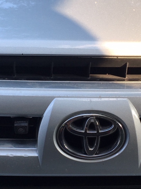

Sorted out my front camera. Went with a Nakita front/rear camera. Great product. Anyway, I got a Toyota-like front camera button and used that to activate it. Screen I used is a Gentex mirror which dims, has homelink and compass. It's an anytime camera which is nice.
Here in PA, no front license plate is required so I hid it between the mounts. OF course, I have to paint it black.
Button. Illuminates amber to match the rest of them.
Couldn't mount it more forward to get rid of the bottom grille, but that is fine by me. I just wanted a camera to get a good idea of what is in front of the vehicle.
