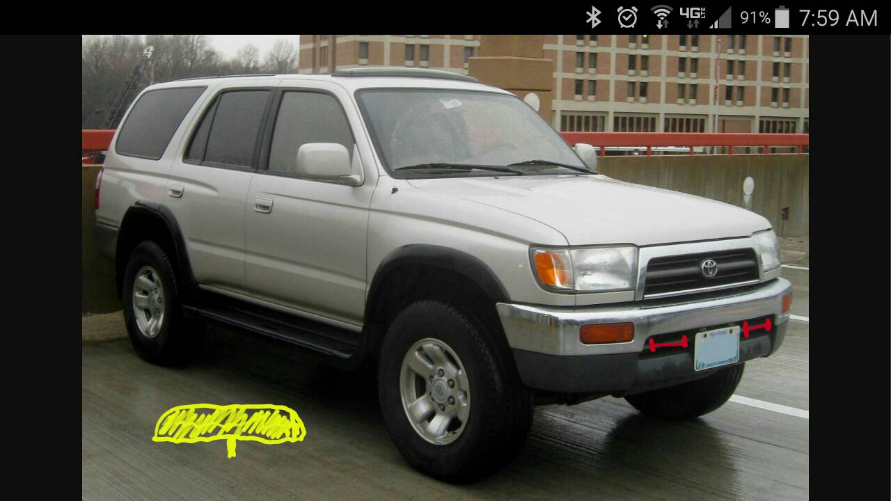

So I bought a set of led lights. They are approximately 6" wide that I want to install in the front valance on either side of the license plate. I was planning on cutting out a section on either side of the horizontal plastic piece on the valance. The mount for the lights is in the center and has a single stud that goes downward. My plan was to drill a hole in the valance and mount it to the platic.
My 97 has lived mostly in the rust belt so my concerns are:
Can i just remove the entire valance?
Should I just remove the entire bumper with valance?
How likely will I be able to remove either of them due to rusty bolts?
Can I do all the work I need while it's all together still?
Thoughts?
PS - that pathetically drawn yellow thing is roughly the shape of the lights and it shows how the bolt will have to go through the bottom.

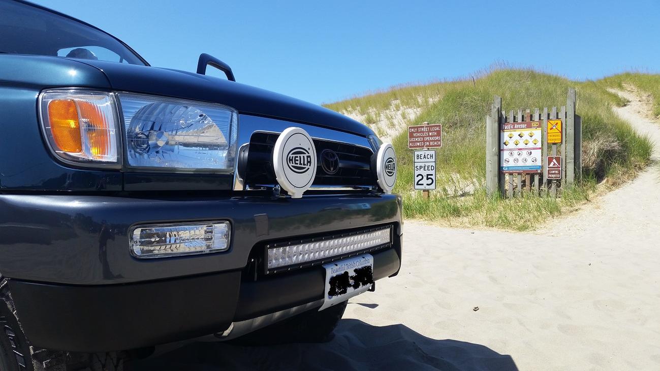

I did the exact thing that the OP is trying to do except with one, larger LED light bar. It's much better to drill the underside of the metal bumper since the plastic valance cannot hold any weight whatsoever without bending and flopping around.

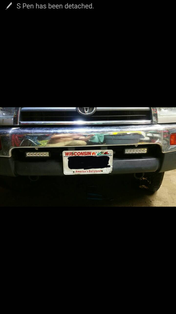

Yeah, I tried to remove the valance with mine but some of the bolts are blocked by the frame. I just cut the valance when it was on the vehicle, marked and drilled the holes in the bumper without removing anything. Was pretty simple that way.
I cut away the sections of the valance that I needed and then drilled in the metal. If you are attaching it to the top, you can't tell if the plastic is still there or not.
I threw a curved one over there and mounted it to the chassis ends, the bolts holding the plastic piece on actually came off really easy after being soaked in wd40. but i removed the whole bumper first, then removed that piece so it did make it easier.

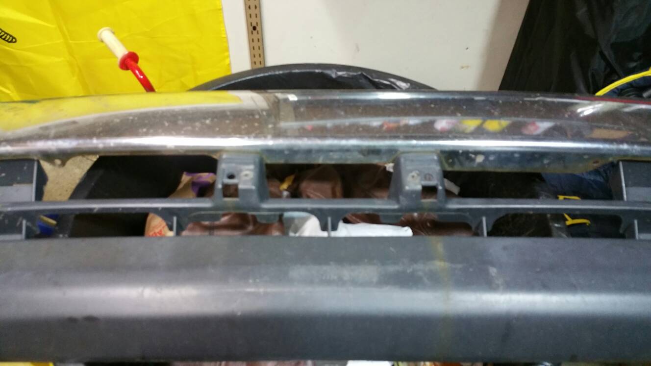

Got them installed. Both of the bolts that hold the bumper on through the wheel well snapped off.
Also, I don't how you guys mounted it to the top of the bumper since there is hardly any material there, especially on one side. I had to make some brackets and use two existing holes.
It turned out pretty good, lights a crazy bright. My only issue is the bumper isn't reinstalling nicely (sags, especially on one side) but it will have to be good enough.
