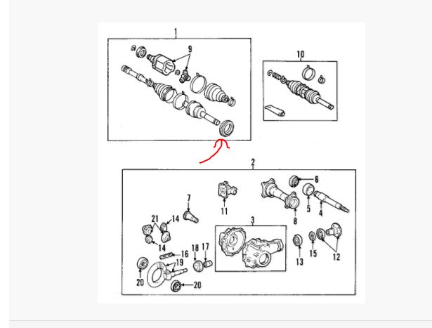

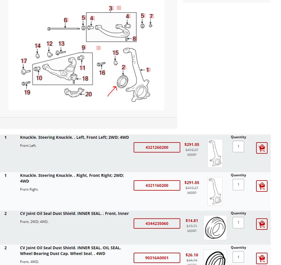

Hi, time to replace my front wheel bearings. I have a stupid question (I've replaced the CVs myself, but never wheel bearings so bear with me...)- is there only one seal on the steering knuckle? The CVJ axles came with a seal installed at the wheel bearing side of the axle, and I want to make sure that is the only seal on the knuckle.
I replaced the CV axles about 9 months ago and I'm hoping I don't need to go that deep with this repair, but I want to make sure I replace all seals associated with the wheel bearings.
I've checked parts diagrams and it seems like there is only one seal, but I want to make sure before I tear into it.
Are the seals in the pictures the same? No need for me to knock out the CV to replace a seal on the knuckle?

The part you indicate in your post is the inner seal, which is located on the back side of the knuckle assy.,, it seals against the axle to keep debris out of the bearing from the axle side. Inside the wheel bearing assy., is a 2nd seal, which seals between the hub and bearing from the hub side. The only way to replace the seal in the hub/bearing assy., is to disassemble the hub by pressing the outer hub out of the bearing assy,. If you remove the bearing/hub assy., thee is also an 'o' ring that seals between the hub and the knuckle, and it should be replaced if you are replacing the bearing assy.
