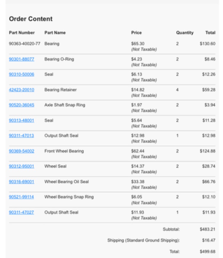

I just did my front and rear axle bearings.... I got all my parts from http://toyotapartsguru.com/ the bearings have a long lead time, just heads up.
Unless you have a heavy press I would not attempt swapping the bearings yourself.
I took my front knuckles off and my rear axles off and brought them to the stealership with the parts. All they did was press the old bearings off and the new bearings on... and they charged me $350 for all 4.
I can not stress enough ONLY USE TOYOTA OEM PARTS!!!
"Pay me now or pay me later"
If you have not replaced UBJ and LBJ I would go ahead and do this as well, with your knuckles off might as well.
