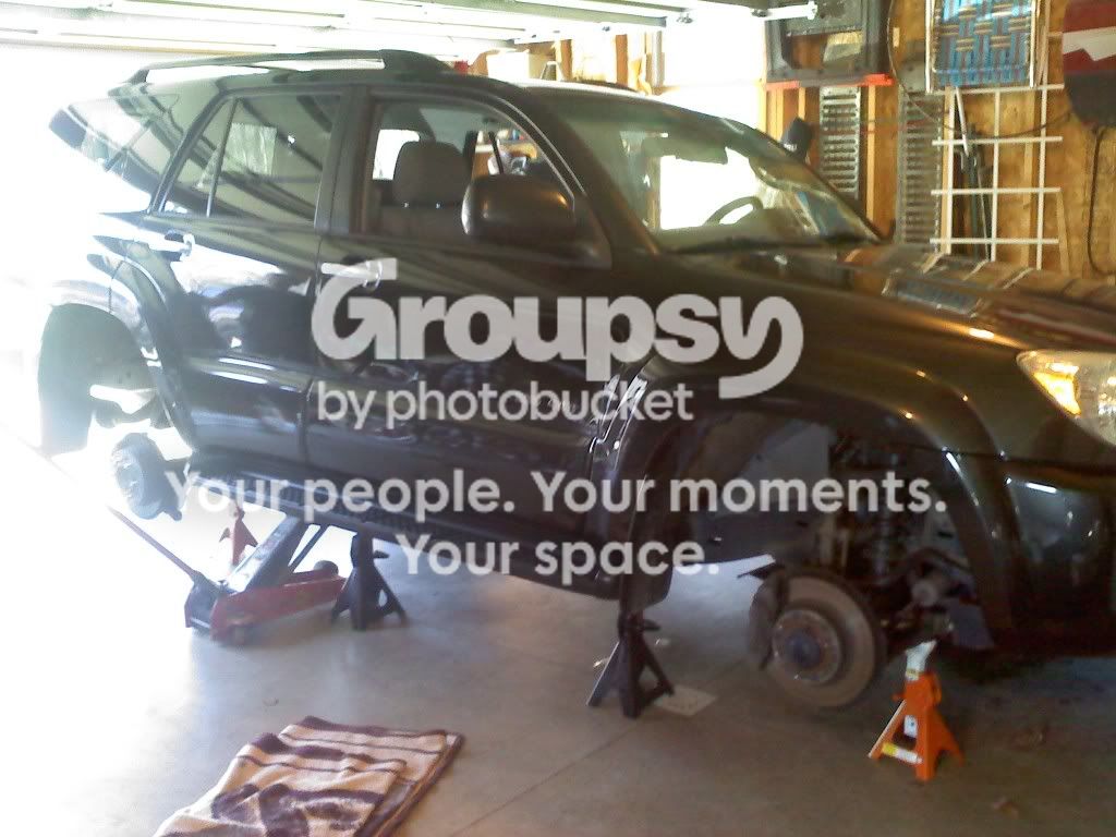

here's what it looked like just trying to do a simple tire rotation. supported in multiple areas since 2 wheels needed to come off.

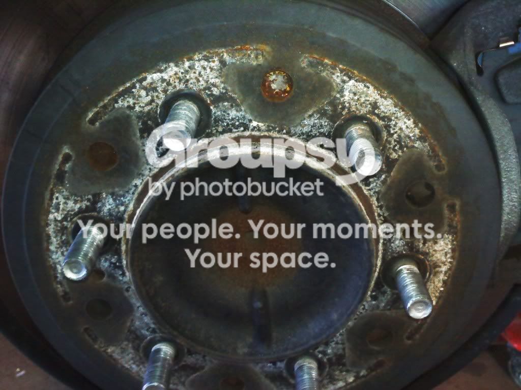

and the reason why the wheels would not come off...
0404021742.jpg~original
I would bet your's will look the same
