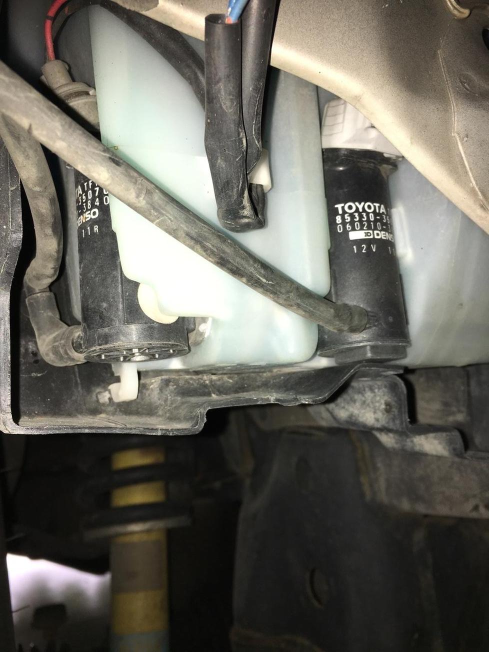

Same issues, but, rear washers work, (you can hear the pump and fluid sprays on rear window), for front, you can't hear any pump kick on.
Is there a fuse just for the front? Or is fuse for front and rear pumps?
Any ideas? Also, already forgot which pump is front and rear, lol.
Disconnect one motor connector. Try to turn on rear washer. Did connected pump work?
Reconnect first one and disconnect the other. Try to turn on rear washer. Did connected pump work?

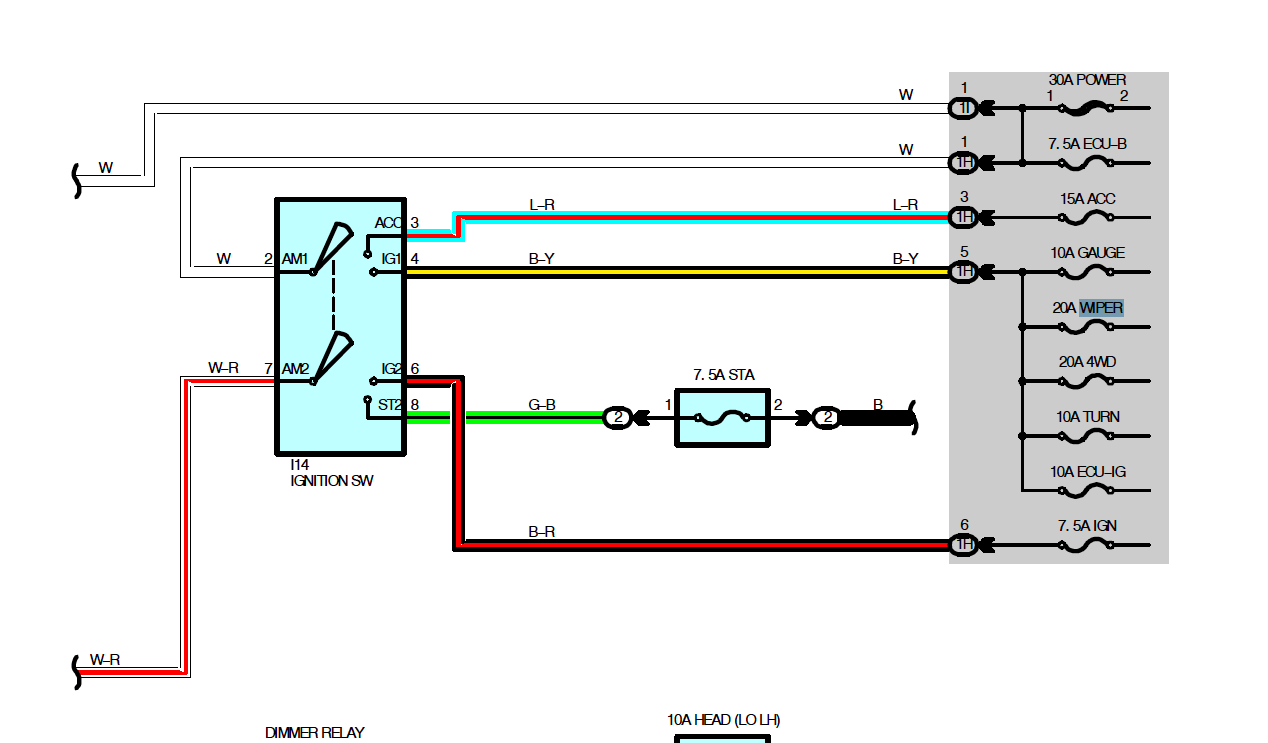

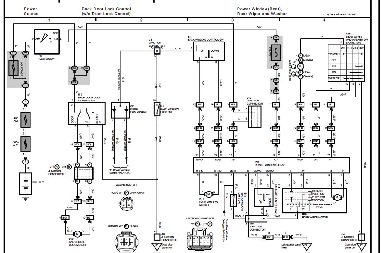

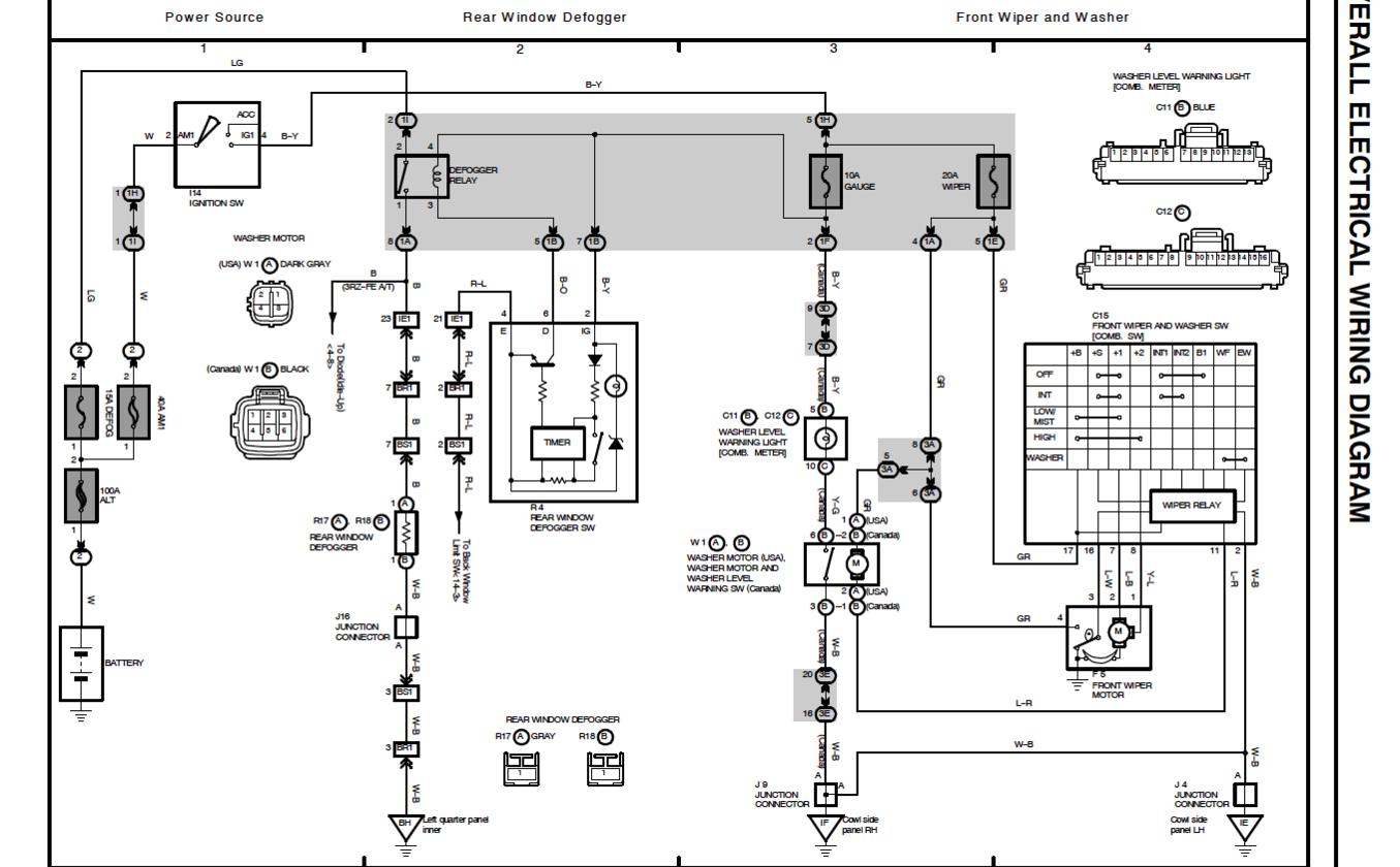

I only see one 20-amp fuse for wiper. Attached are for 1998 4Runner...

Will check soon. Btw, checked another post and for those that were asking earlier in this thread... The front motor is on front right of my pic, and rear motor is the one on passenger side of tank.
Find out which motor and connector combo runs. Then switch motors and connectors. Whichever follows the problem is the problem. :)
