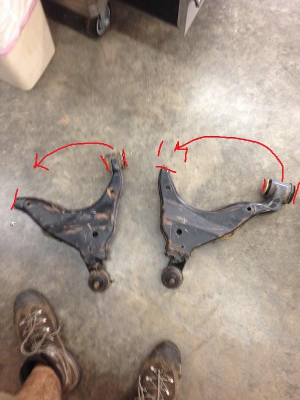

Thank-you! Sounds like you went with Raybestos. Do you happen to have pictures of where you cut it? What did you grease them with.
So the opposite joint from each side was frozen for me. I had to cut the control arm where you can see to get it out of the way for me to make the cuts on the bushing and alignment bolt tab parts that were seized inside the mounting brackets. Marked up the picture a little to try an clarify.
this was the only photo I took that day apparently. hope it gives you an idea.

Absolutely does. To keep my LCA now and just replace bushing, rather than cutting the arm - I would just drill through the cam bolt to free it?

Check out my post (http://www.toyota-4runner.org/4th-gen-t4rs/219531-low-caster-angles-after-lift-2.html#post2369578). I recently did it. First you need to cut off the seized bolts to release LCAs. Then no drilling just torch the rubber, get rid of inner sleeve and saw the outer flange, knock it out. After decent cleaning I used the copper grease that works great as an anti-seize.
Torching the rubber makes a stinky mess. Just put the control arm in a vise, heat up AROUND the bushing, use a ball joint press and an impact to get the bushing out.
