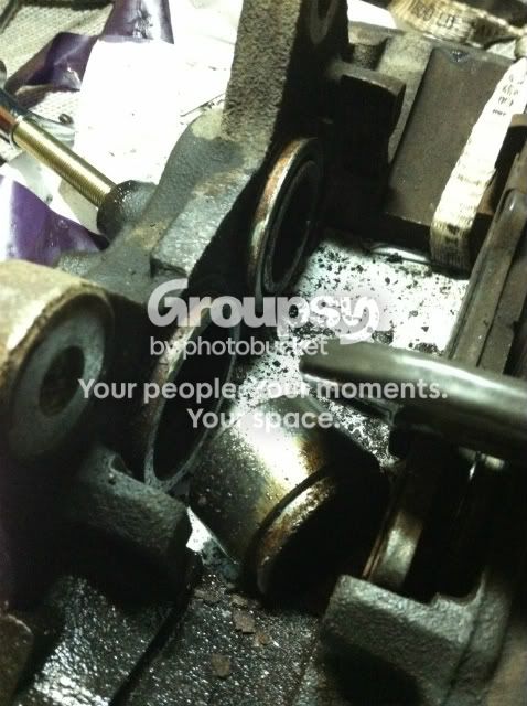

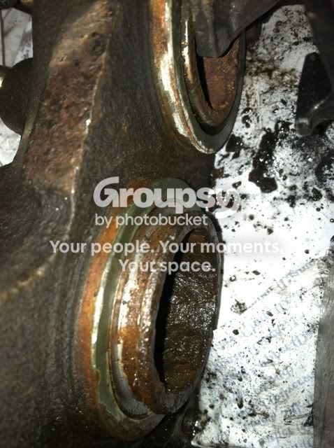

Busted into the front drivers side today. Removed the old pads and rotor then pushed the break a couple times to get the pistons in the caliper to drive out further. Lower inside piston was completely seized and looked very rusted the one above that didnt drive out as far and seemed rusted as well. The others seemed fine. Sucks......
After fighting with the caliper for a couple hours and trying to get the seized piston to come out we hooked that sucker up to the compressor and shot it out like a cannon. Took a while to find the right adapters to get the compressor to screw into the brake line.

Seized pistons blasted out
I didn't get the seized one on video but it was pretty awesome when it shot out. It shot out like a cannon ball or bullet break dust went everywhere.
Seized piston

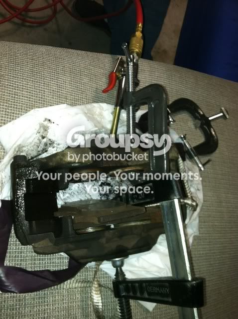

Rigged up caliper with vices compressing the 3 pistons. Getting ready to shoot out the seized one.

KABOOOM

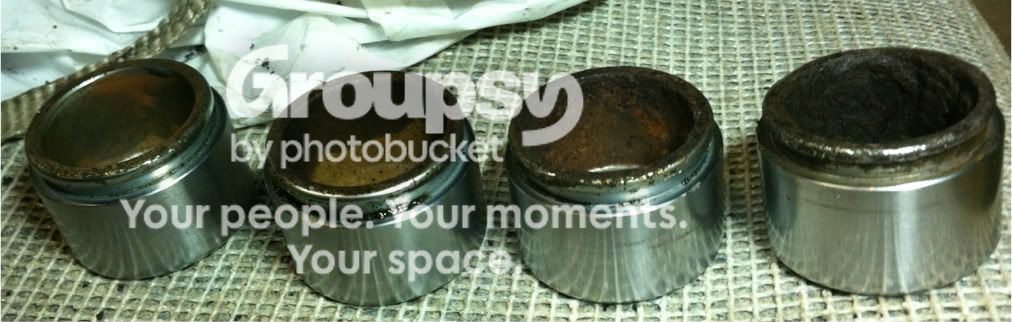

Got them all out and cleaned them up a bit

So yeah I guess if you are giving up hope on stubbornly seized caliper and have a compressor and some time... you could give this a shot.
