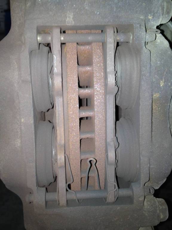

I replaced both my front calipers in Nov. 2010 & now my left front is frozen AGAIN! Less than 2 years?!?!?!? Come ON!
I took the caliper off and most of the pistons were very hard to push back in with the lower inboard being the worst. I worked them a couple of times until they moved fairly easily & then I decided to take the dust boots off the pistons. The top outboard piston showed a light coating of rust residue that cleaned off with a rag but the piston looked ok. The lower inboard piston however was badly rusted and there was rust powder about the bottom of it. This leads me to believe that water is getting past the rubber dust boot & sitting there rusting the piston. So it seems that the majority of the problem is coming from outside not inside (like from contaminated fluid).
So, has anyone thought about putting some kind of grease or similar inside that boot? Maybe silicone grease (not sealant)? I'm trying to think of something that may make water penetration harder (to help the boot seal better) & something to coat/protect the exposed (outside of the actual seal) part of the piston. I think I'm going to have to replace this caliper again soon & want to try this. Anyone have any suggestions about what to put in there?
