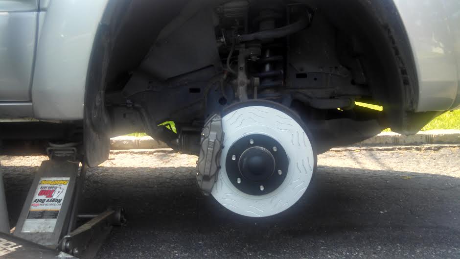

Just had to replace both front calipers.. I have the larger sport edition calipers.
Both original with 105k on them..
The passenger side outer 2 pistons were frozen.
The Drivers side lower inner piston was frozen.
Replaced with Raybestos Pro grade calipers.
Also did a complete brake fluid flush.
Changed rotors to Raybestos r300 rotors in the front and Pro grade in the back
Pads changed to akbano premium ceramic OEM all 4 corners.
Pedal feel is excellent... Truck stops smooth.. Straight and hard enough to put you thru the windshield if needed lol.
