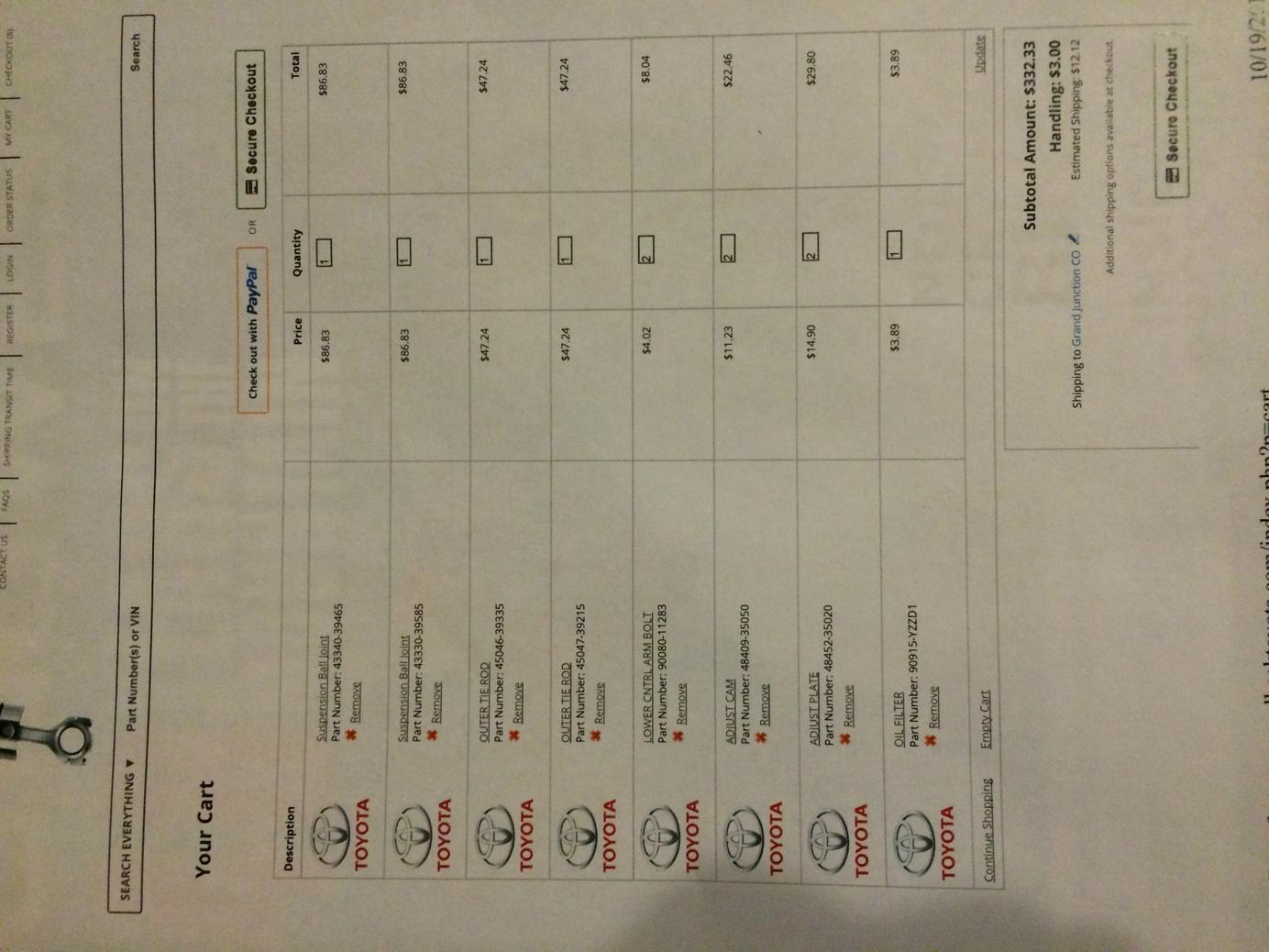

I see. Maybe I'll order a bolt and bushing then take it to get aligned, so they can replace it while they're in there. After I do the ball joints that is...
Thanks, I'm hopeful now haha
