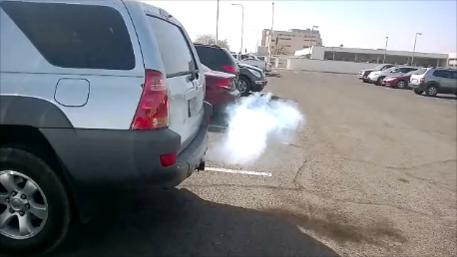

Picture of smoke during start up
I'm tried attaching a video of the smoke during start up, but the file was too big I guess. Here is a snap shot of the video. This was at about 10:30a.m.

That looks like coolant. Did it smell sweet like coolant?

If that thing smokes like that all the time, it would have to go low on coolant. I'd mark where the coolant was in the overflow to see if its dropping any. If yes, something didn't go right on the head gasket job. Example, the heads weren't checked and are warped. If the level stays the same, I'd guess that the valve guide seals are gone. My mother's S10 smoked like that only at startup. Turned out the bad seals were letting oil down into the combustion chambers causing the smoke. Hope this helps.

The photo helps a lot, thanks. How long does it smoke like that? I'm wondering how long it takes to burn off whatever it is that's smoking. Maybe you mentioned it already but I didn't see how long it lasts. Does it burn off in 10 seconds? 60 seconds? If you shut it down after the smoking stops and re-start does it smoke all of again?
It's sure looking like a bad head gasket...
It is ONLY during start up, then it stops. Also, work on the heads was just finished the day before this picture was taken.
