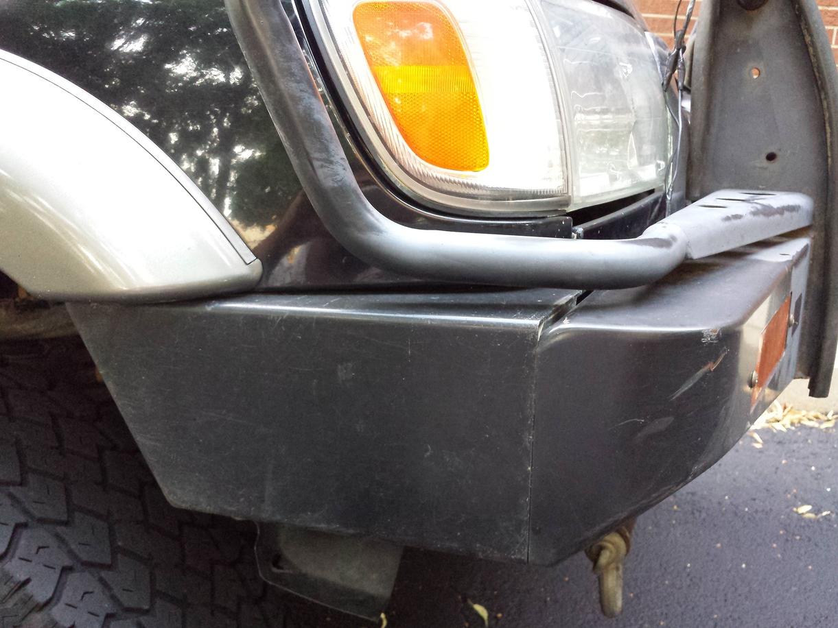

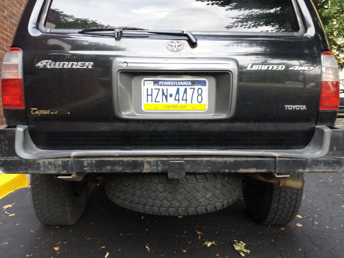

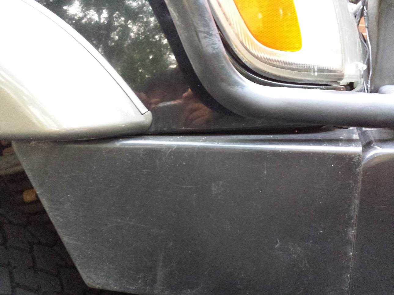

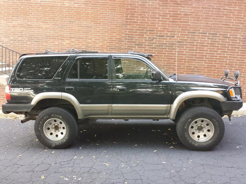

Can anyone chime in on a side pic of the gap ? I think I wanna do this but I need to make sure it's not goofy
Here ya go

no gap issues
