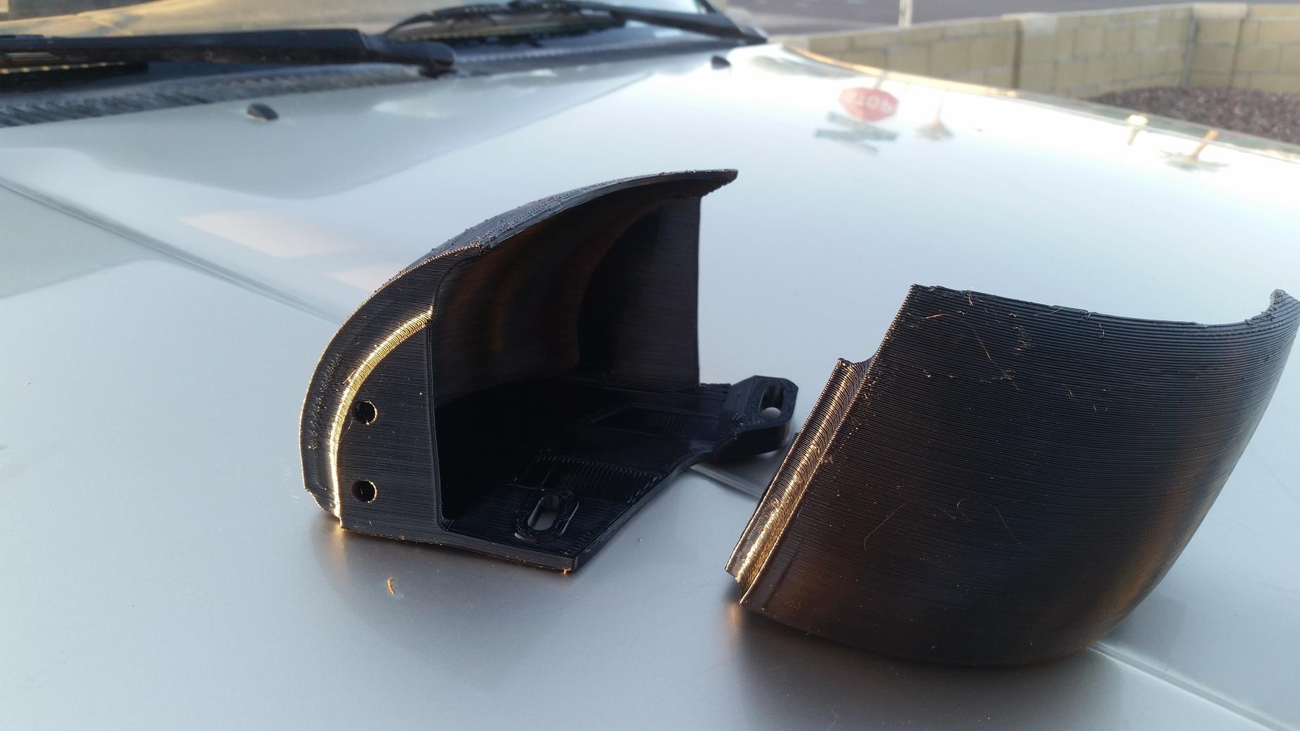

FS: 3d Printed SR5 Flare Caps $80 3rd gen
Hey guys, semesters over and was able to get my printer going again. I should have 5 "RAW 3D PRINTED" sets ready on monday. When I have them done, I will pm the first 5 people to post after this post that are ready to pay. They are $80. If you dont know how 3d printing works, do some research so you know what to expect.
If you plan to finish them yourself, I suggest using a sandable self leveling primer on top($6 at autozone), and then painting with a trim paint or flat black paint. I think they actually look good raw, they blend in pretty well after going wheeling a few times.

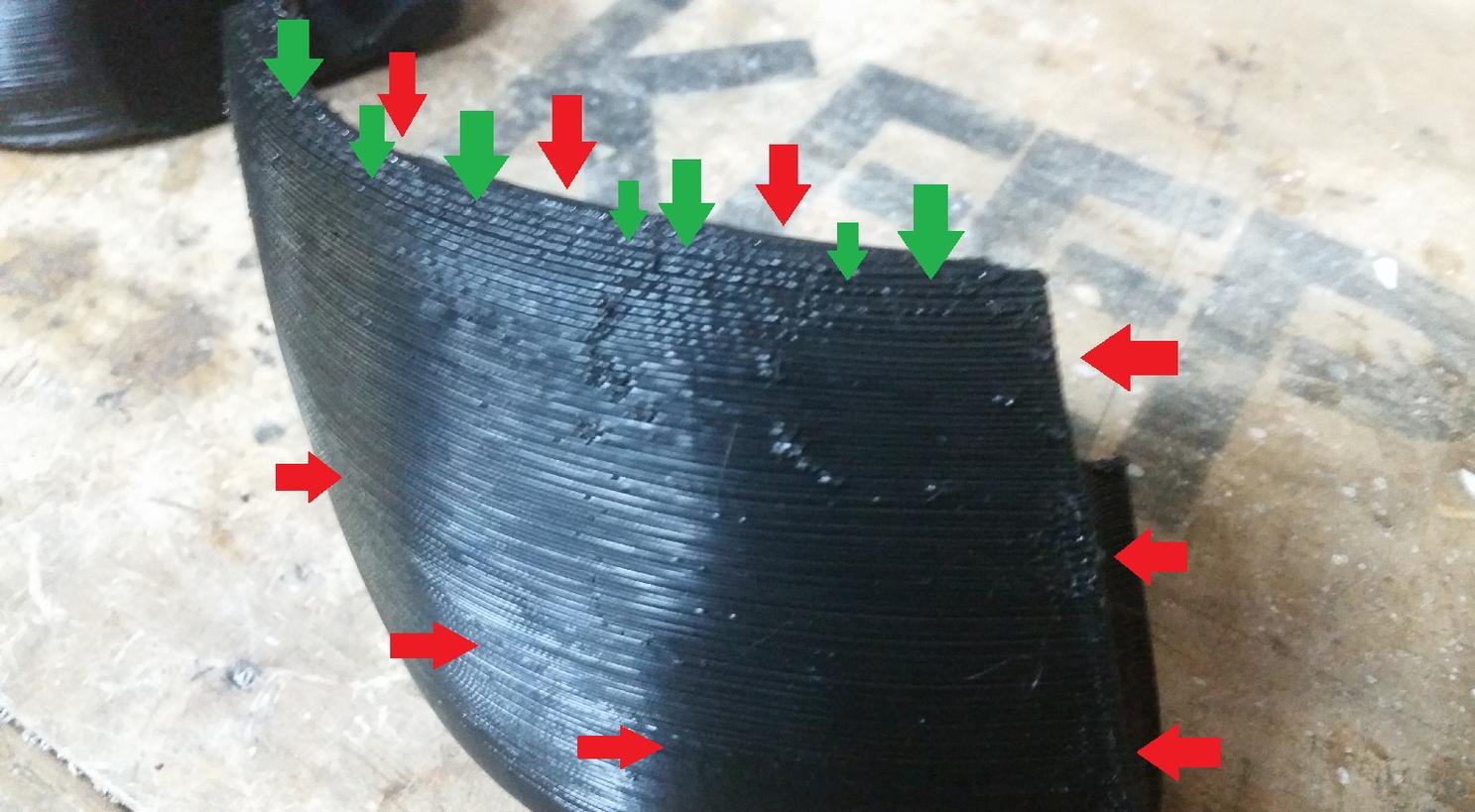

Get a knife and scrape off any boogers on the surface, specifically right where the red arrows are in picture 1. if you scrape down the surface layers to be more flat where the green arrow is pointing, it will make it a lot easier later on.

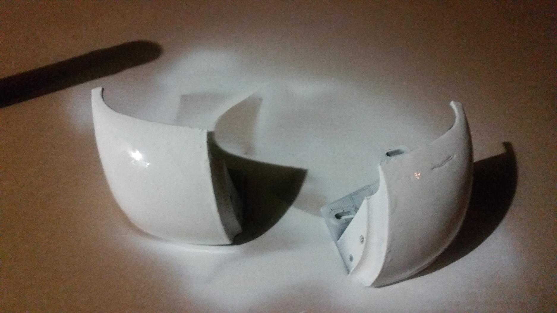

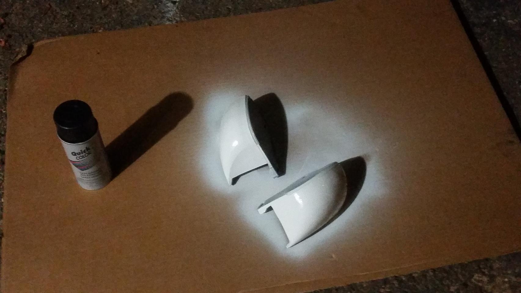

After all the boogers are gone, blow off any plastic shavings from scraping and set your pieces up, alternate between the positions in picture 2 and 3 so you get everything. Get out the 2 in 1 filler and primer and start laying down coats, just dont overdo it to the point where its running. I found it helps to have a fan pointed at the parts while they are drying inbetween coats, but make sure no debris gets on them! Id put probably between 6-8 or more coats on them. you should alternate the part between the two positions to get even coverage.
Step 4: Sanding
Wait the full 4 hours before doing this step, trust be its worth waiting. you can use a foam sanding block or whatever you have to sand the filler down until its smooth, from my experience in order to get rid of the ridges, it had to be sanded even though it was supposedly self leveling. sand it down till the ridges are gone, then wipe off with a damp rag.
Step 5: Final Paint

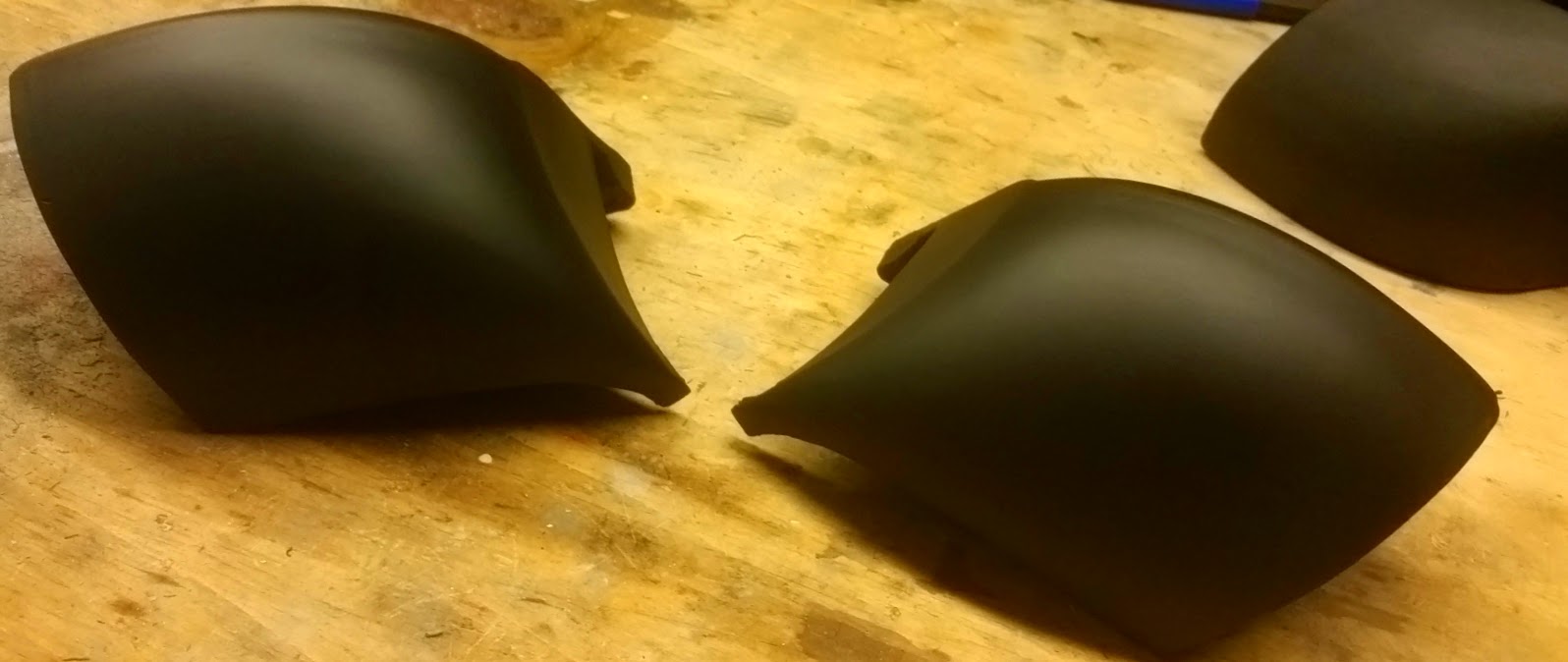

hit it with a couple light coats of the primer and then 2-3 coats of your favorite black paint or truck bed liner. wait for it to dry then install.
