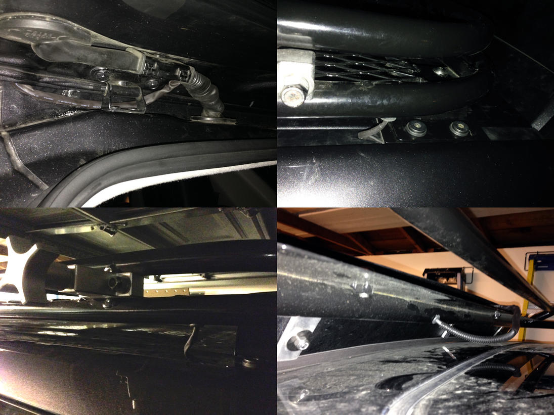

Wired the roof rack...
Pretty standard path through the inside...then pulled up thought the existing rubber grommet/seal and up into the driver's side roof rack channel.
Pics...

Awesome, I almost started a new thread on wiring, but this is so clean. What gauge wiring did you run? And I'm assuming it's both hot and gnd in the loom?
Yes...both hot and ground all the way from the driver's side (hot from the engine - painless 7 connection) and ground at the bracket under the switches.
I used 14 gauge stranded. Bought the grab bag of rubber grommets (all from Home Depot) which fit 3/8" perfectly.
Drilled both holes @ 3/8", basically wanted the rear hole just in front of the mount so the wiring would be firmly in place as it ran between the bolts under the rack mount - there is just enough space there. And drilled the front just after the curve but before the center as there is reinforcement in the tubing and wasn't sure I could get the wire cleanly through that section. I just used some thin non-insulated solid wire to fish the wire through. It actually worked out really nice.

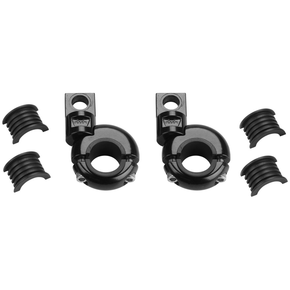

What about some universal tube mounts and mount it to the top bar but hanging down... not sure how much space you have on the outside of the a pillars.
This is just an example...
Looked at those but they didn't look like they would work - they were my first thought though. I bought some rigid a-pillar mounts to test and unfortunately the angle isn't 45 degrees (not that big of a deal) so they aren't a great match either. The biggest issue is the a-pillars blocking the path for the led bar.
