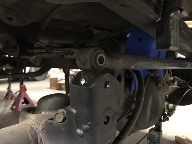

Thanks for the clarification. The Whiteline bushings have side flanges that contact the walls of the bracket. My assumption was that they should be supported. Also, if your bushings have this design and you install with only the sleeve spacers then the bushing flanges will be halfway in contact with the walls and also a sharp edge at the width transition. Could that cause damage to the bushing in operation?
Could you post a picture of the bushings you're using?
EDIT - I see a photo above. Is the face of the bushing completely flat? I'd probably still just support the sleeve, to give the bushing flanges more room before they're pinched between the mount and the bar end when it twists, but if you're still on jack stands you can check the amount of squish pretty easily by pulling the shocks & springs and moving the axle through its various arcs. The WL bushing flange may have enough room with the plates your using - but you'd need to put an eyeball on it to verify.

The face of the bushing is flat and matches the width of the factory bracket.

grind the top of the spacer flat if you're using the middle hole (simplest way). A couple of clever folks over the years have relieved the factory mount to clear the spacer though, which is pretty slick.
