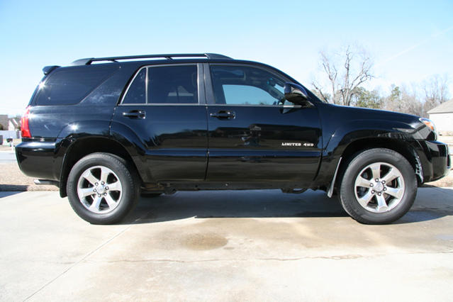

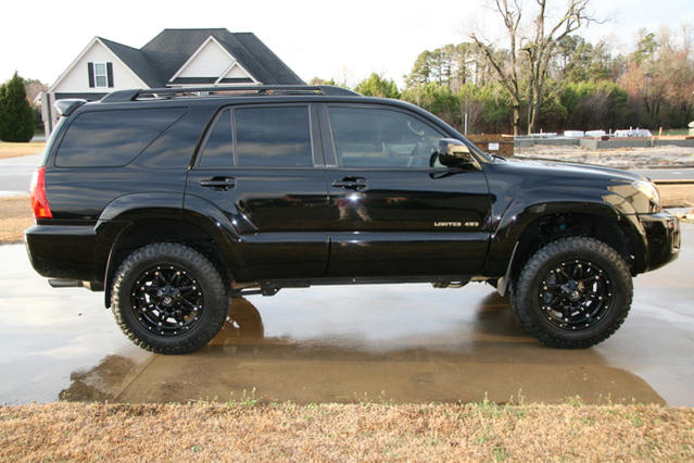

I also measured before and after my lift and tires and here's what i came up with..
Stock
Ground to wheel well
Front- 33.75"
Back- 36"
Now
Ground to Wheel Well
Front- 37.5"
Back- 38"

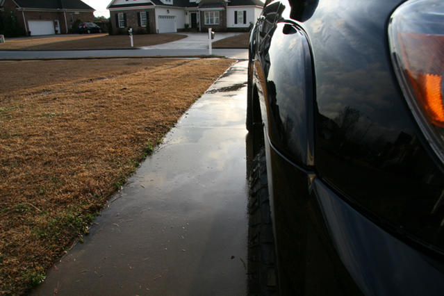

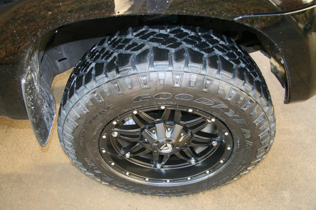

...and god do i love it. I also know that with the tires i did get a little extra height. The fitment is great. With the wheels turned all the way left and right in reverse and drive there is no rubbing at all and im amazed. I read a lot about this size of tire and got different answers. They feel great on the roads and really quiet. Heres the pictures..
Before
After
Now that i think about it I didnt grab a picture with the tires turned all the way left and right which wouldve been a good idea. Id be happy to do it.
