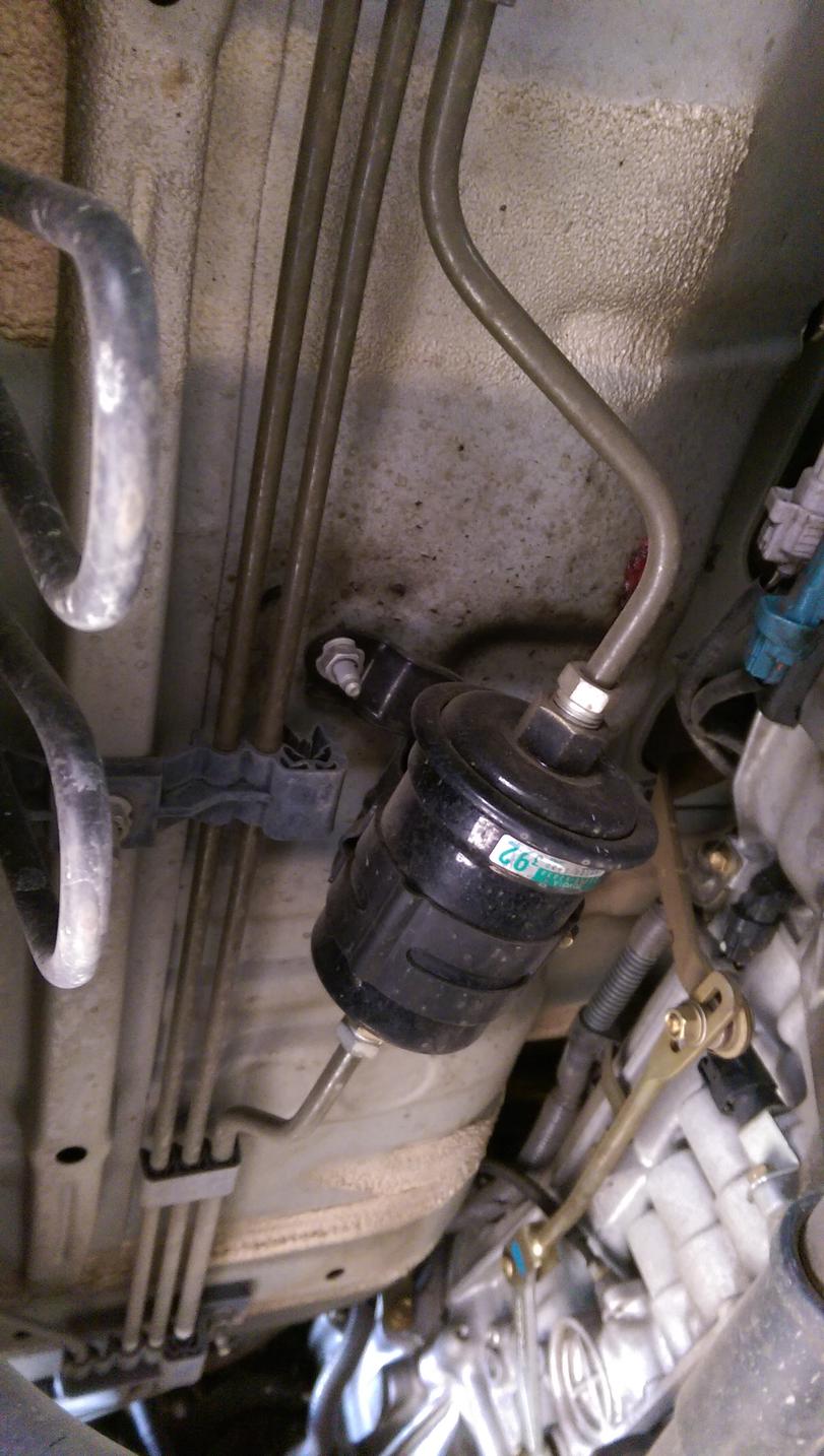

The only tricky part I experienced, and others have spoken to this as well, was getting the fuel line nuts to line up with and thread onto the new filter correctly. I wonder if maybe folks are trying to attach the bracket assembly first? I left the filter bracket loose from the vehicle and attached the fuel lines first. With a little force and a little twisting I was able to pretty easily get the threads to line up with just my hands. Once I was able to thread the nuts on most of the way by hand, I knew they were threaded properly and that I could move back to using a wrench for the final turns. I don't have a torque wrench and so estimated the (I believe) 18 pounds of torque required to tighten them. Very scientific, I know, but they did not leak! I read horror stories about folks having to go back and re-thread/re-tighten but mine went fine the very first attempt. Done!
I took the beast for a test run to see if I could tell the difference. Prior to the new filter install I had noticed the vehicle had started to feel "heavy" and a little sluggish. The idle felt just a little bit rougher than it had in years passed. I'd also noticed a slight smell of gas when I first start her up. This last noticing may have nothing to do with the fuel filter but I thought I'd start with the simplest solution first. As I merged onto a street near my home, turning to the right, I peeled out a little. This does not normally happen! It also seemed to me that the vehicle was peppier than before and seemed to run smoother, as if not working as hard to get fuel. This could be all in my mind (confirmation bias and all) but it definitely FELT better. I'll watch my fuel consumption for a more objective review...

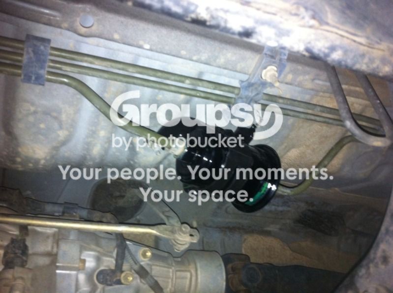

Not as bad as i thought it would be...
living in Hawaii has its benefits with good weather and minimal rust if you stay away from the ocean..
everyone's horror stories of impossible fuel filter changes made me worried, and the whole depressurizing the system had me jumpy.
Here are my 2 cents
All i did was open the fuel cap and let that depressurize, then after letting the truck cool off, sat for about an hour, i started my fuel filter change.
I did NOT do anything else to depressurize the system other then the fuel cap and put some PB blaster on the fuel filter nuts.
Flare nut 14mm in hand, expecting an impossible opening, it actually opened without much force.
No fuel came shooting out under pressure, just what i expected just lots and lots of dripping from whatever was in the lines..
i just let to drop enough till it was a slow drip then cracked open the nuts all the way and continued with the change.
The nuts holding in the actual fuel filter itself are 10mm and those were cake.
Then change the fuel filter to the new and reinstall in reverse order.

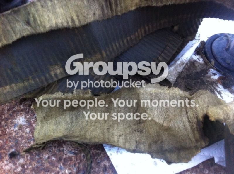

as everyone cracks open the fuel filter to see the 15 year damage..
9718b048.jpg~original
Used a hacksaw and vice to open it up.
3f80ea46.jpg~original
To my amazement, it really wasn't that bad at all.. HAHA

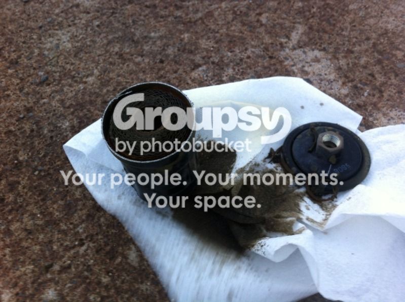

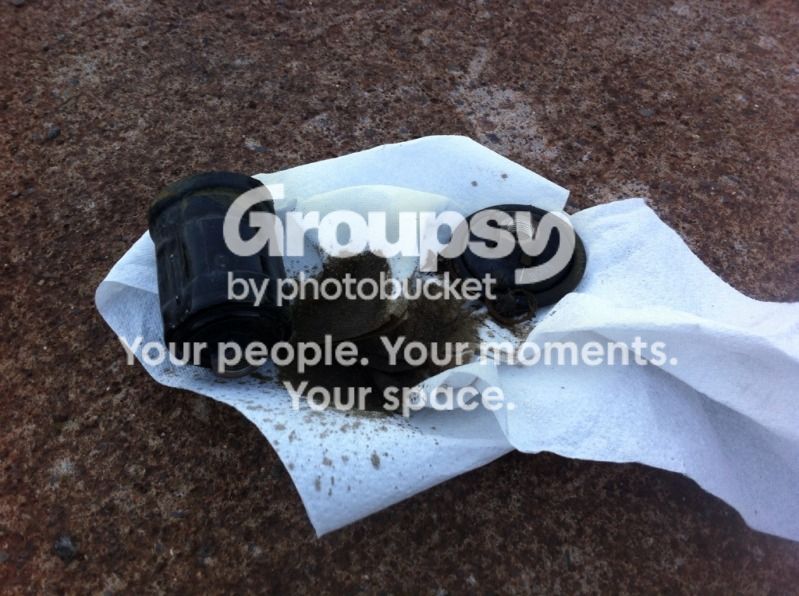

b71e519f.jpg~original
Close up.
34aa2d89.jpg~original

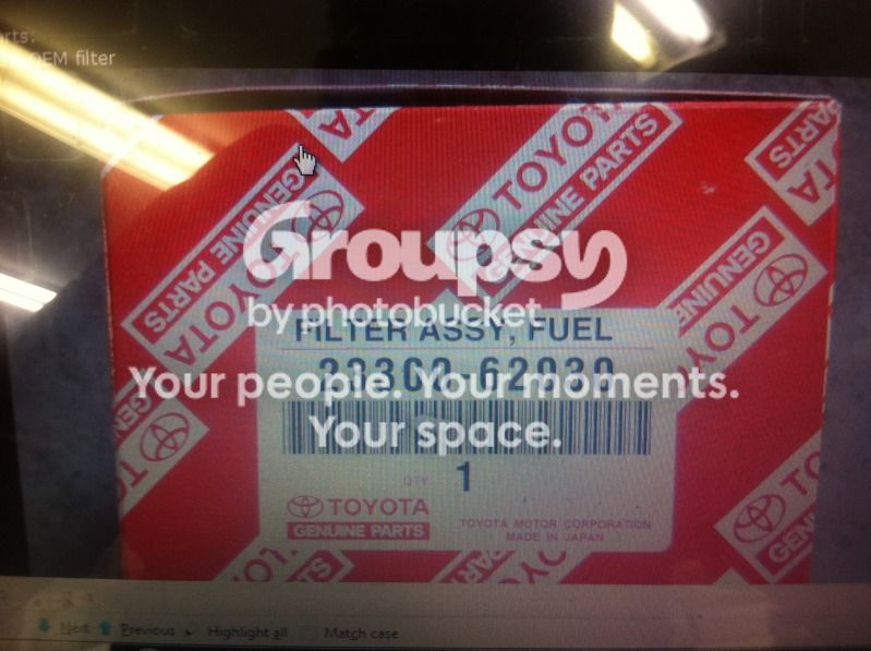

Part number for those who need.
f75480f6.jpg~original
At my toyota servco parts dealer the fuel filter was $45

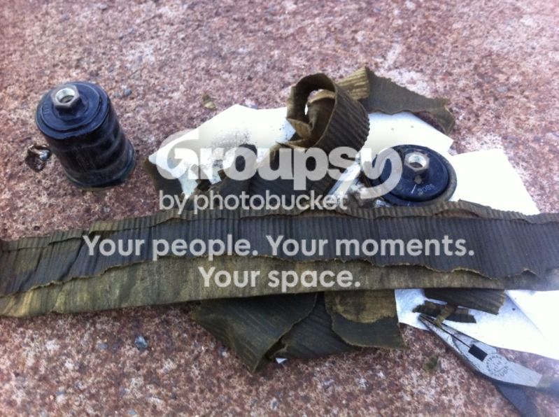

Conclusion:
15 years with OEM filter, not bad at all. I have 136,xxx miles on my truck.
It was definitely dirty "looking" but no crud or crap or dirt or anything that didnt look like old fuel.
The fuel that drained out was clear as new and only the filter had some old dirty looking fuel. Meaning the fuel filter was still doing a good job and i am glad i went with an OEM filter. Knowing i got another 15 years to not worry about.
