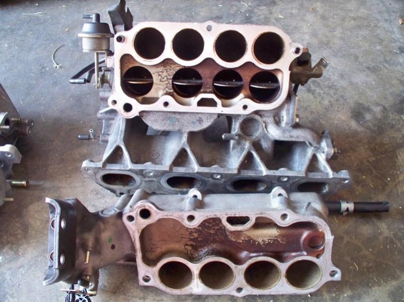

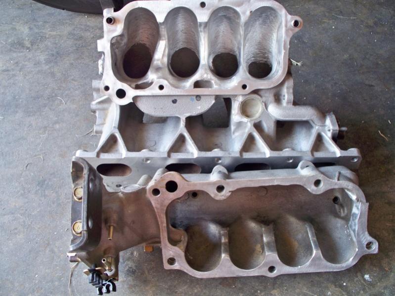

I don't like plastic. Are you talking about the 2005-09 V8 intake manifold? Yes I am talking about porting out the intake manifold. I want to do it to the oem intake manifold because I want it to look very stock. These pictures are from a Mazda Miata. I want to do the same to my V8 4Runner but would it adversely affect the performance of the car like make it run too lean? Top pic is after it was ported out and the bottom is when it was stock. I have Doug Thorley headers.

Also has anyone on here ever used an oil catch can for the 4Runner? It's suppose to make the intake more clean by collecting the oil in the catch can instead of allowing it to go into your intake. Notice how in the bottom picture the stock manifold has oil residue inside

Porting an intake should be done by a professional who can monitor the air flow cfm and match the ports, etc. If you're going to try and put more air in you should install headers too to get the air out too.
I've never heard of this done on the 2UZ, while not to imply it hasn't been. However, the plastic late model intake manifold has variable length intake runners which give better power through the entire RPM band with a vacuum operated valve system.
It's hard to predict the flow characteristics once the intake is carved up, as rdruss pointed out. The late model plastic intake is a cheap, easy, bolt-on upgrade that's commonly done.
Lots of these motors have 300,000 miles with that intake on it and the plastic intake is not an issue. For the ease of install and the benefit of the dual length runners, it's wins across the board. Add to that it's lighter than the early model intake. It's hard to go wrong with it.
