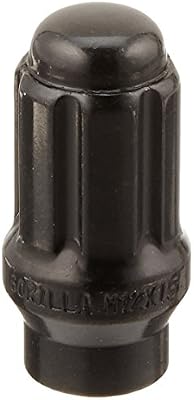

I used these Amazon.com: Gorilla Automotive 21134ETBC Black 12mm x 1.50 Thread Size Chrome Finish Small Diameter 6-Lug Kit, (Pack of 24): Automotive
These are the most basic version

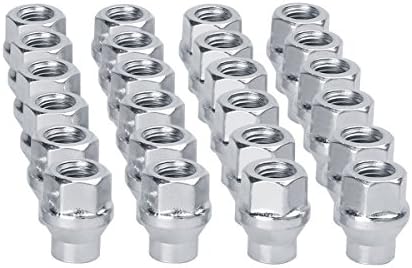

Amazon.com: dynofit 12mmx1.5 ET(Extended) Lug Nuts for 6 Lugs Aftermarket Wheels Only, 24pc M12x1.5 Open End with 7mm Shank Lug Nuts for Toyota with Conical/Cone Seat, Special Lug Nuts for Spacers: Automotive
Don't know that I would use splined nuts again, it's one more thing to go wrong.

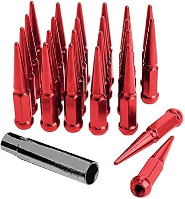

If we were real men, we would rock these
