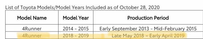

Did you check your VIN to see if your 4R is on the fuel pump recall list?
Lookup Safety Recalls & Service Campaigns
Also, is your manufacturing date (which is stamped into the tag on the driver door jamb) within the range listed in the Toyota recall document? Page 5, A5:
https://techinfo.toyota.com/techInf...echinfo/html/prelogin/docs/cp/20TB02tofaq.pdf
