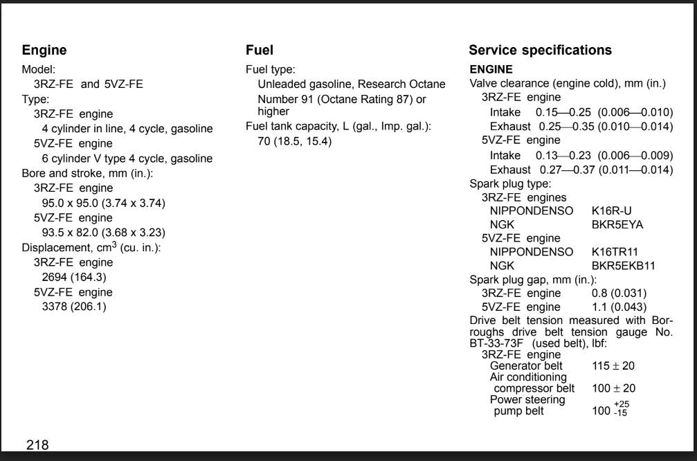

Don't think so. I just checked owner's manuals for both years. 18.5 gallons, just like the others. Here is 1997:

Neither can anybody else. That's not what 18.5 gallon capacity means. At empty on the gauge, there are still a couple of gallons left. You can go below empty quite a ways before the truck will starve for fuel. Even THEN, there is gas left in the tank. Between one and two gallons.
Also, the venting system is kind of funky, and frequently you can't get the tank all the way full. The pump clicks off, but there is still airspace at the top. I think the most I ever pumped into mine was a little over 14.

The tank is 18.5g. Most vehicles have around 2 gal reserve so at empty you should be around 16g. But in our trucks the float does not report correctly and you have around 4 gal reserve and its why we only fit 14-16g on almost all fill ups.

It holds 18 gal. But when empty you have 4 gal left. So you only fit 14 gal. If you constantly clicking the pump to get more fuel in the tank you just feeding the fuel back into the pump and your not getting fuel your paying for. You also filling up your evap canister maybe causing damage to it.
