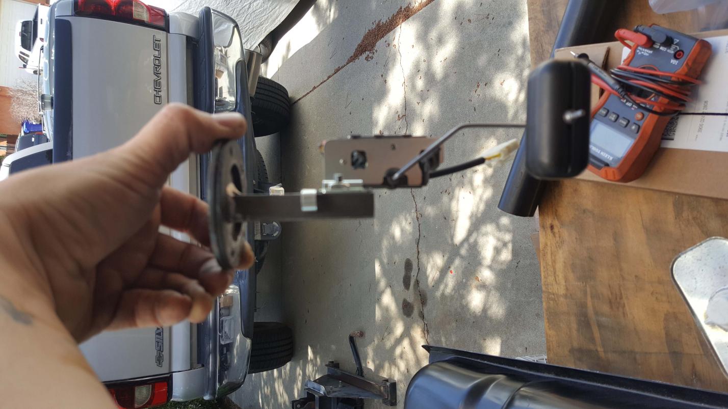

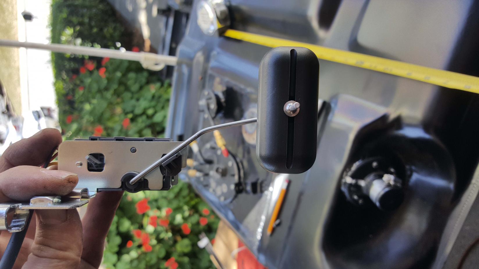

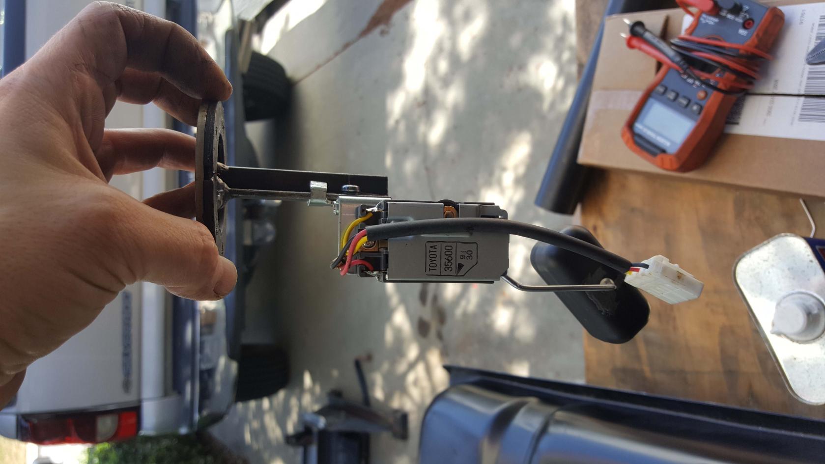

Well got the oem sender modded and swapped in. Had to much other stuff to do so I didn't take any measurements. Just some pics. Tank will go in next weekend as I left some tools at work. One thing I did was flip the float over so it "free spins" on the level arm. It creates more clearance on the top and all I had to do was adjust the roughly 45 degree bend in the arm and make the 90 degree for the float.
