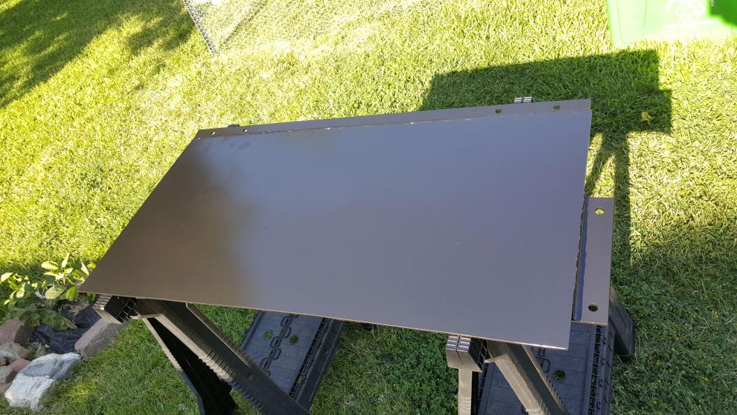

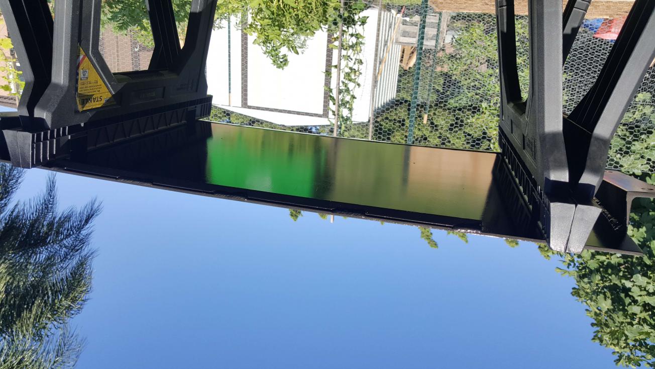

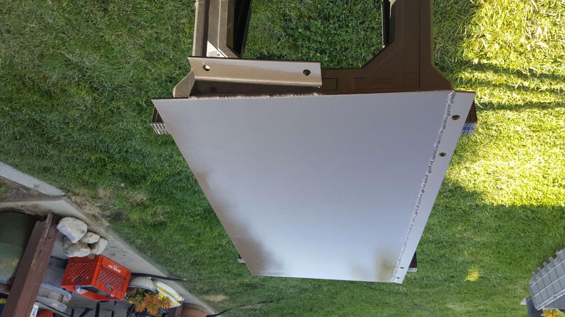

Got the tank skid made! Came out awesome, lots and lots of cutting and grinding. And now it's beverage time! Added a front stiffner for more rigidness. Don't know the weight but it's heavy. I went 19" deep and 37.5" wide with around 3/8 clearance under the f150 tank sump bump thingy. Painted it the same color as the bumper. Tomorrow will be installing it, watching paint dry is boring. And upside down pics cuz why not?
