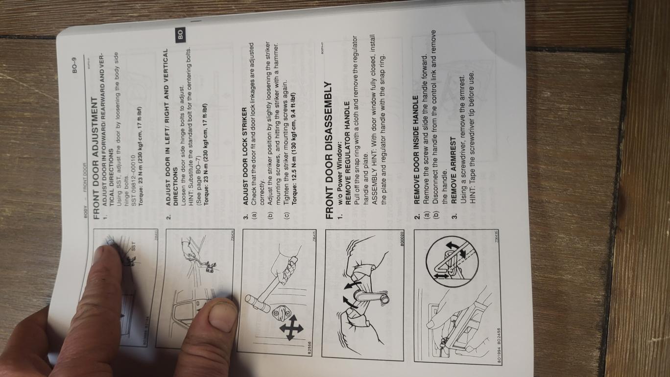

How to remove the door panels with cranks handles?
I am new so I can't create new posts. My apologies for piggy backing on this thread.
I have one of those unicorn 3rd gen 4runners 5sp with no ac and crank windows.
I found a tutorial in 2010 on how to remove the crank handle to get the door trim panels out. (There was some trick spring behind the crankhandle it seems like. Too many concussions so I CRS these days). I got them out and installed new speakers and got them back on.
Iirc , it was tricky but not too frustrating. Now, one of those speakers has rattled out of the mounting screws and is slapping around inside of the door. It is annoying AF.
Long story short, I can't find instructions on crank handle removal.
Apologies.
My memory is so bad that I was just reminded that I bought the factory service manual.
Picture in case it helps any future window cranker.
*the technique in the manual is far easier than the one I found online uears ago*
