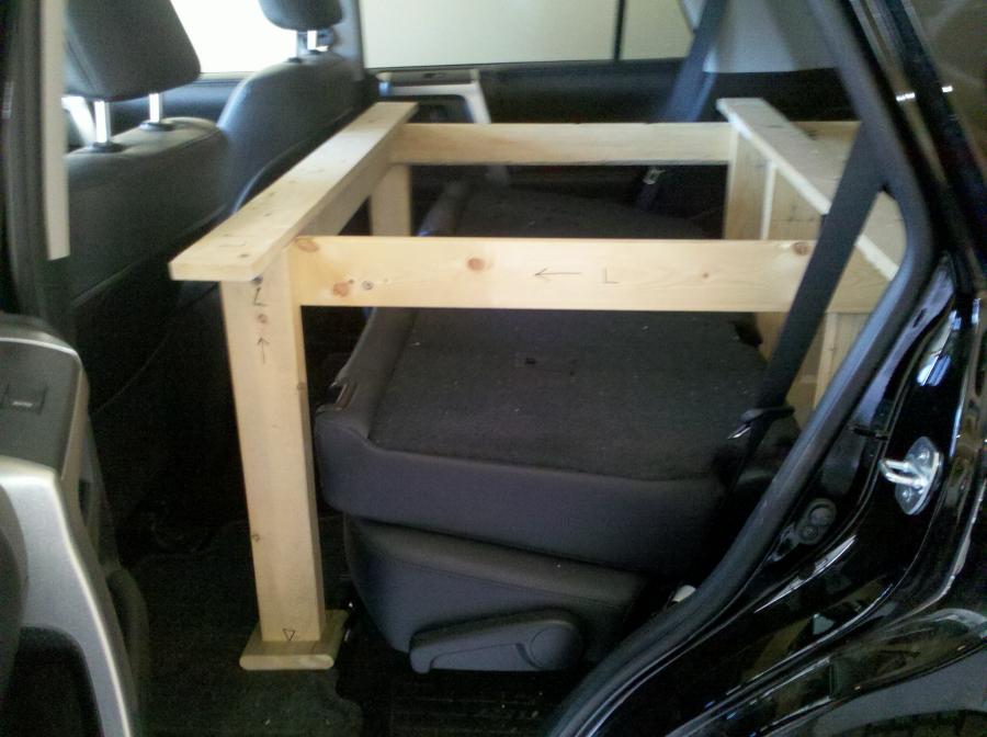

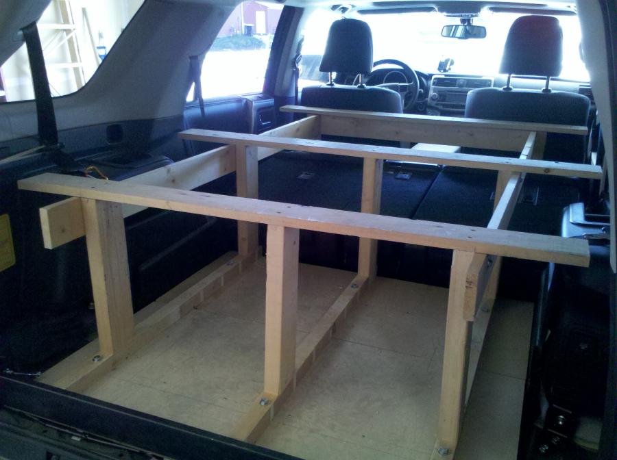

This is something I did like you said. You don't have to rip the second row.
I put a board on top and made it flat like a bed. I didn't use it as a bed, but it could be. I took the measurement, it's about 55"x70". It is light weight but very sturdy.

Cool. my rear seats are slightly different. The bottoms fold up and rest against the back of the front seats, then fold the back down to make them flat. Not any space to place anything on the floor like you have. So I loose about 10" of space with the bottom folder forward. Hence me thinking of just 2 bolts per side to remove. Figured, going camping, remove seats and leave the bed in the back if we go shopping or whatever.
But the wood design was about the same like you have. Looks easy in, easy out when I'm not using it.
