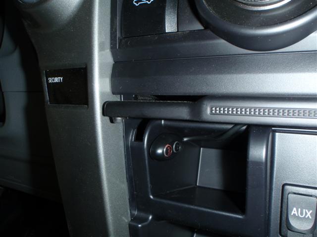

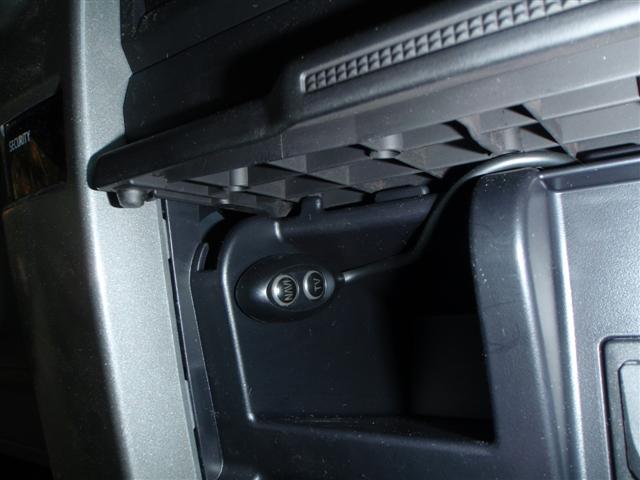

Works Great/Clean install
Bless the forum for leading me to these guys. As I live in Southern Cal, drove to see Mark and had him put it in himself. Works perfectly.
Installed switch as shown behind panel. When it's shut, no sign at all:

The price for the module is $299.49 plus 8.75 tax and $75 installation charge.
We offer a 10% military discount so your $269.54+$23.58+$75=$368.12.
Ill be heading up on Sunday to get it installed.
