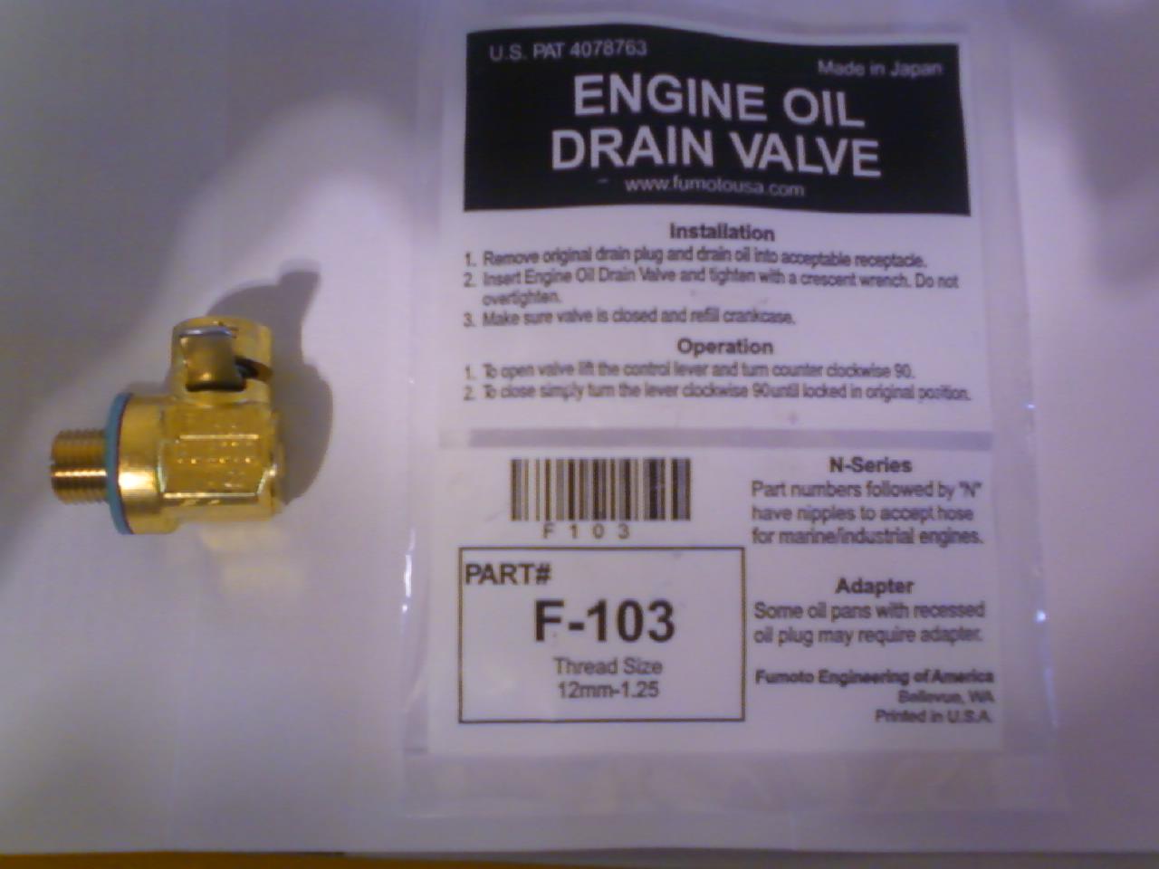

I bought a Fumoto F103n (which is listed on their website that it will fit my 2004 4runner (4x4 sport). However, when I tried to install it I can see it's too small to fit. The website says it's 12mm (which I confirmed by measuring the F103). I believe the 4runner has a 14mm bolt. After a few searches through the forum it seems that many here have installed a F103 on their 4runner. Is there an adapter needed? Or am I missing something?

EDIT: Received mine the other day, looks like it should fit to me, although I'm not due for a change just yet, it will probably be another couple of weeks....Have you had any luck supercliff?
I'm not sure which part # I have but my Fumuto fit perfect, I have not used it yet (just installed) but I love it already :thumb3:
Good report here as well. I have had the F103N in the truck since the first oil change. No problems. Do you have a pic of it with your drain plug?
Does the 4th Gen's plastic cover over the access to the drain plug still fit with the Fumoto valve installed?

well i have had mine on since Sept of last year and not one leak so even a hint of one. hands down, one of the best things i have gotten for the runner since i do all my own work.
I put mine in around July 2010. I have the F103N (with nipple). Works great, no leaks so far. As far as the torque, I just snugged it up until I felt comfortable that it was tight enough, and did not over tighten. The plastic piece: was missing when I purchased my 4runner, and I don't see a need for it. Also, the F103N should not stick out past the skid plate.
