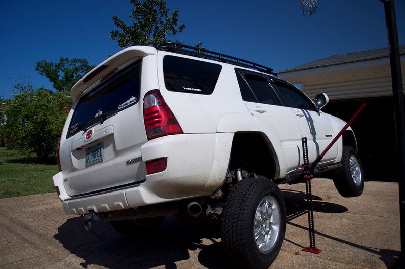

It's pretty easy, would be easier with sliders and a hi lift, but all you have to do is disconnect the rear shocks and the sway bar end links then jack one side up until the spring basically falls out, put the new coil in, then do the same on the other.
It only takes about 20-30 minutes and the most tedious part is removing the nut from the end link. I'd recommend getting a ratcheting wrench (or set) for that part!
edit- pictorial -
Hmmm...maybe I'll try it. I do my own brake work, oil changes, and fluid changes. But suspension has always intimidated me.
