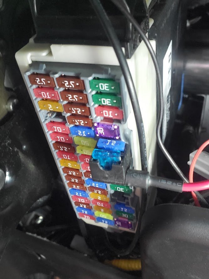

I see people are running power for their radars and dash cams to the fuse box by the driver's footwell. I was curious, after adding a tap there is no way to get the cover back on obviously. Is there something you are all doing or buying to cover the fuses, or are you just running it naked?
Naked

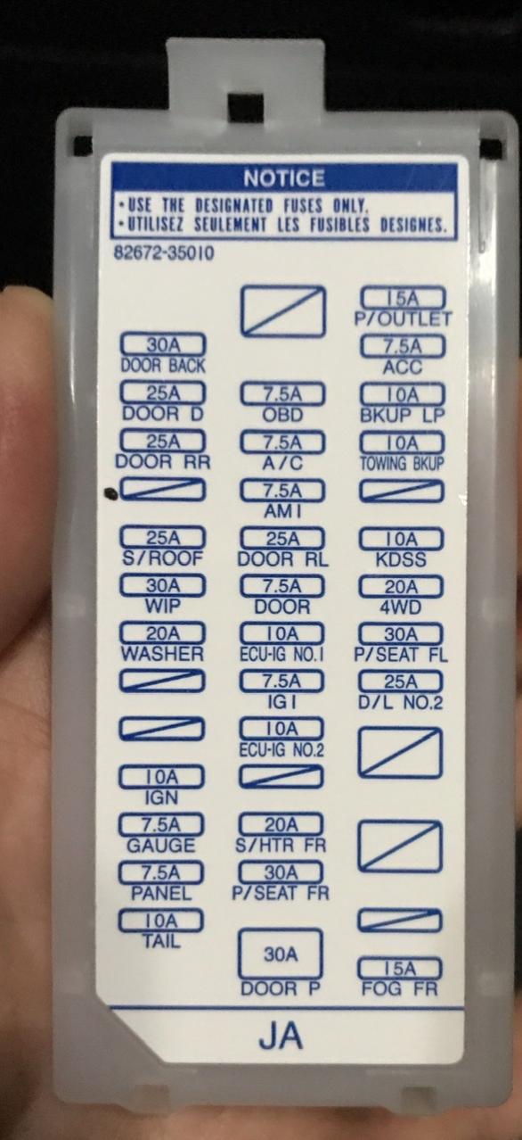

Peel the fuse label off the cover and stick it on the manual so you still have it as a reference.
I used a little rat-tailed file to create matching grooves in the cover and the fusebox to let the new wires sneak in under the edge of the cover. They're a little snug, but I like knowing that the fusebox still has protection from dust/water/salt!
I just cut mine to get the cover to fit back on and have the tap extend out. It works OK, but I must have kicked the cover the other day when getting in/out and it came off along with the fuse tap.

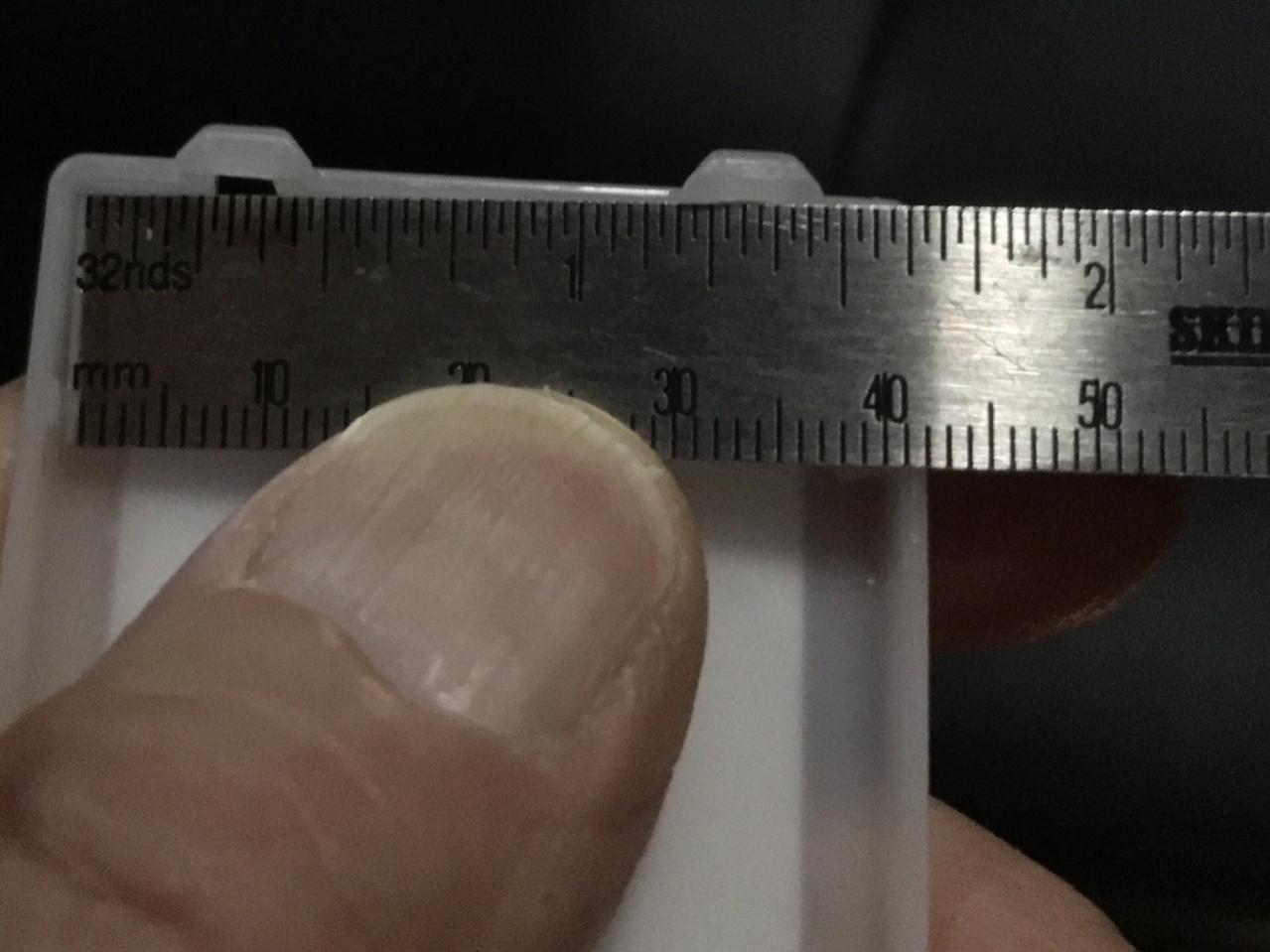

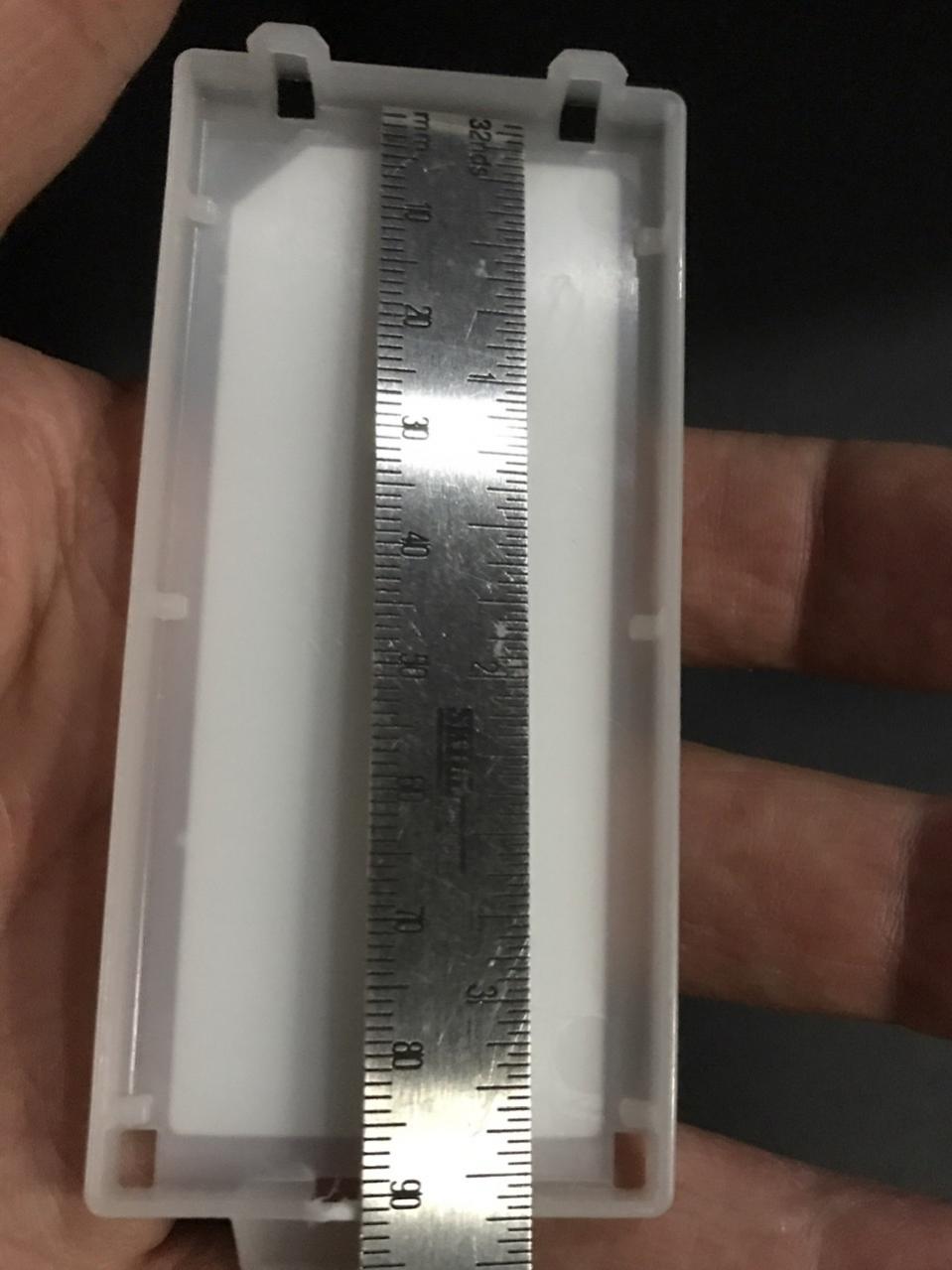

The fuse box layout changed for the 2020 model year. I’m not sure if the physical size did also. I have a 2018 ORP. The cover is 41mm X 91mm on the inside that would snap over the fuse block. Does this sound like your design?

You are right, I think it was the 6th gen that I saw, because the tab on top on the 5th geb is on the opposite side as well...
As far as the inner dimension, I could easily change that to match, but getting correct dimensions for the tab on top may be problematic, and that tab has a locating hole in it to grab a tab... The ID is 40mmx103ish.
