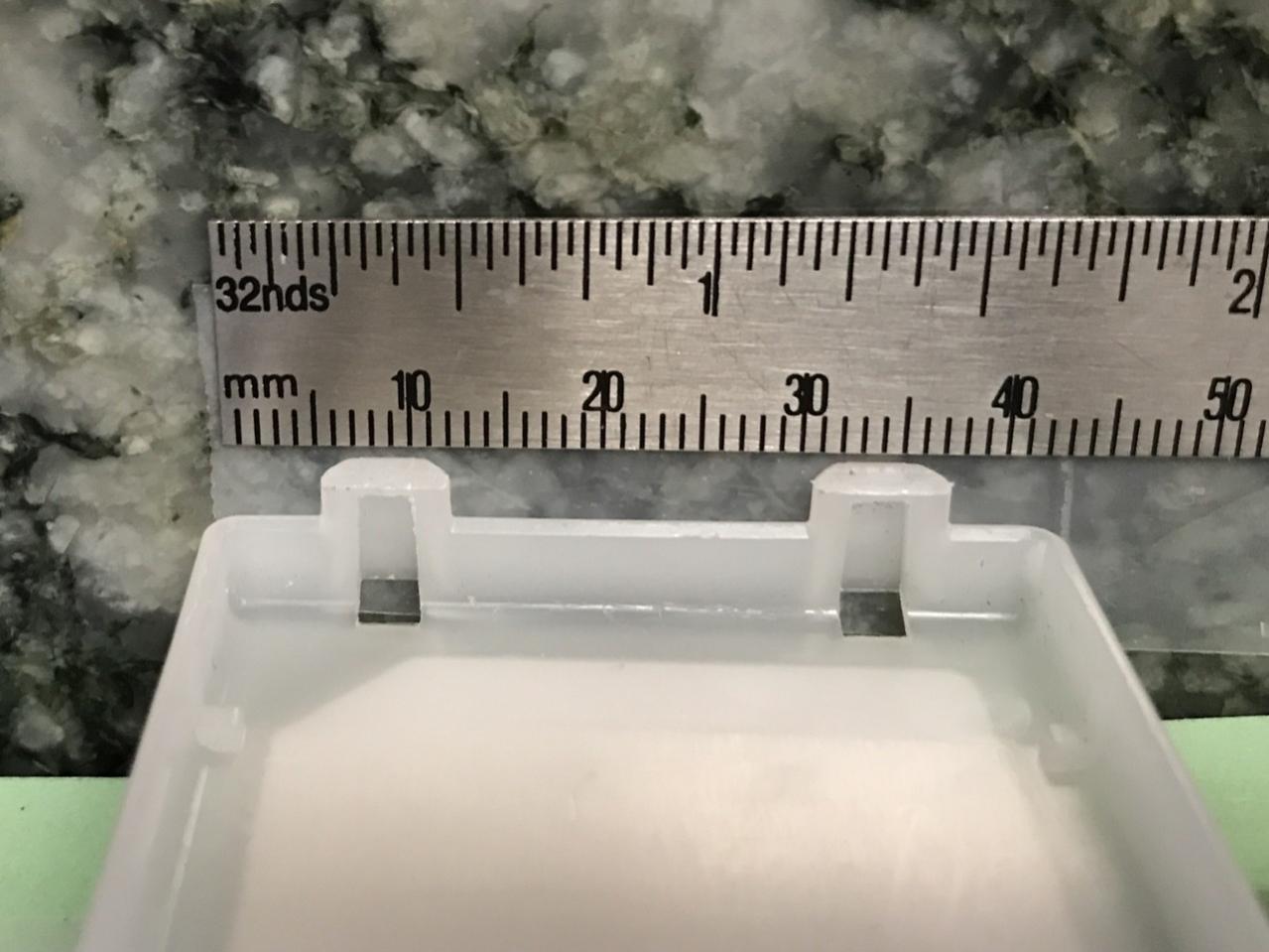

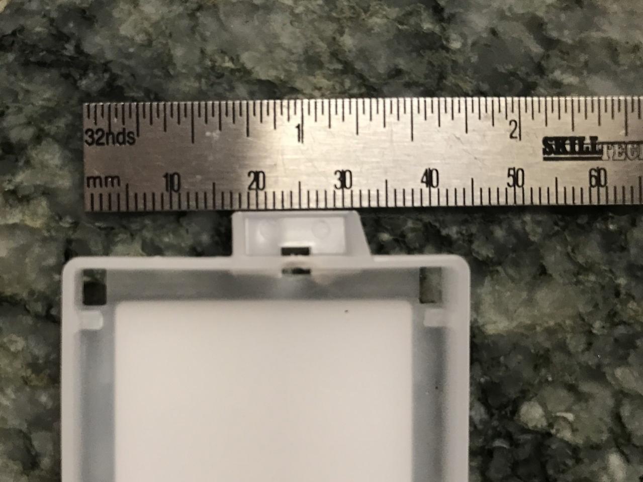

As far as the inner dimension, I could easily change that to match, but getting correct dimensions for the tab on top may be problematic, and that tab has a locating hole in it to grab a tab... The ID is 40mmx103ish.
When I measure from the backside top left corner as origin, it’s 23 mm to the left edge of the hole. The hole is 3 mm wide. From the right edge of the hole to the right edge it’s 15mm. Total 41mm. The tab itself is 15mm.
Then there’s the bottom tab/holes.
From the backside left top corner: 7mm to the first hole edge. Hole is 3mm. From that hole right edge to left edge of next hole is 22mm. Hole is 3mm. Then 6mm to the right edge. Total of 41mm. But the hole placement is not symmetric.
There are some tolerances involved here, it may not make much of a difference, but I could mail you my cover if it would help you get better measurements.
PS, the ID label is 84x34 mm.

If you would like to send me your cover, I can do that, but based on your measurements, I think I was able to get it pretty close. The top offset tab, just appears to be a mirrored version of the other cover I have, but the bottom feet where also inset a little bit.
I have changed the model to reflect these, its up to you if you want me to print this model out and set it to you, or if you would rather send me your cover first.

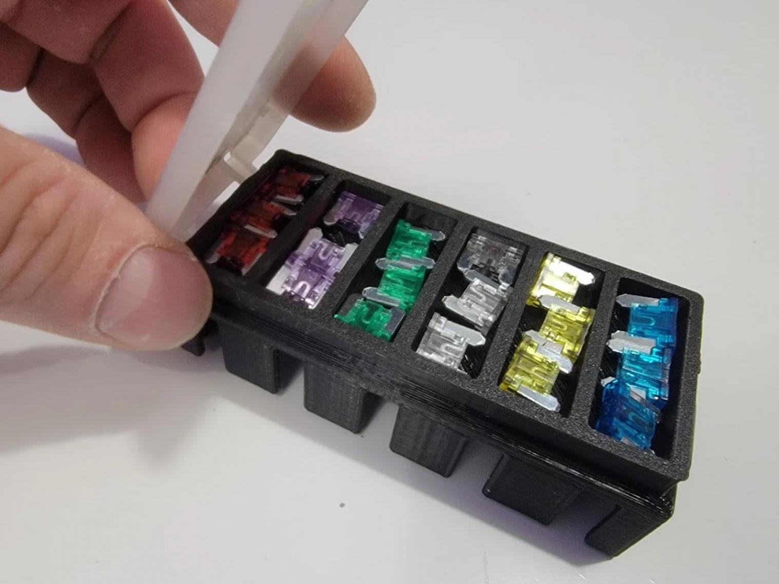

fit is excellent and you can reuse the factory cover. plenty of room for add a fuses as well
Yeah, I bought one from [MENTION=611141]ihateu3[/MENTION] from his Etsy Page (HldMyBeerEngineering) for my 2022 Subaru BRZ which is oddly the exact same design as the 4Runner Fuse Box for my 2015. :D So, I know it works well. I was just trying to give him credit and get the design I know I already like.

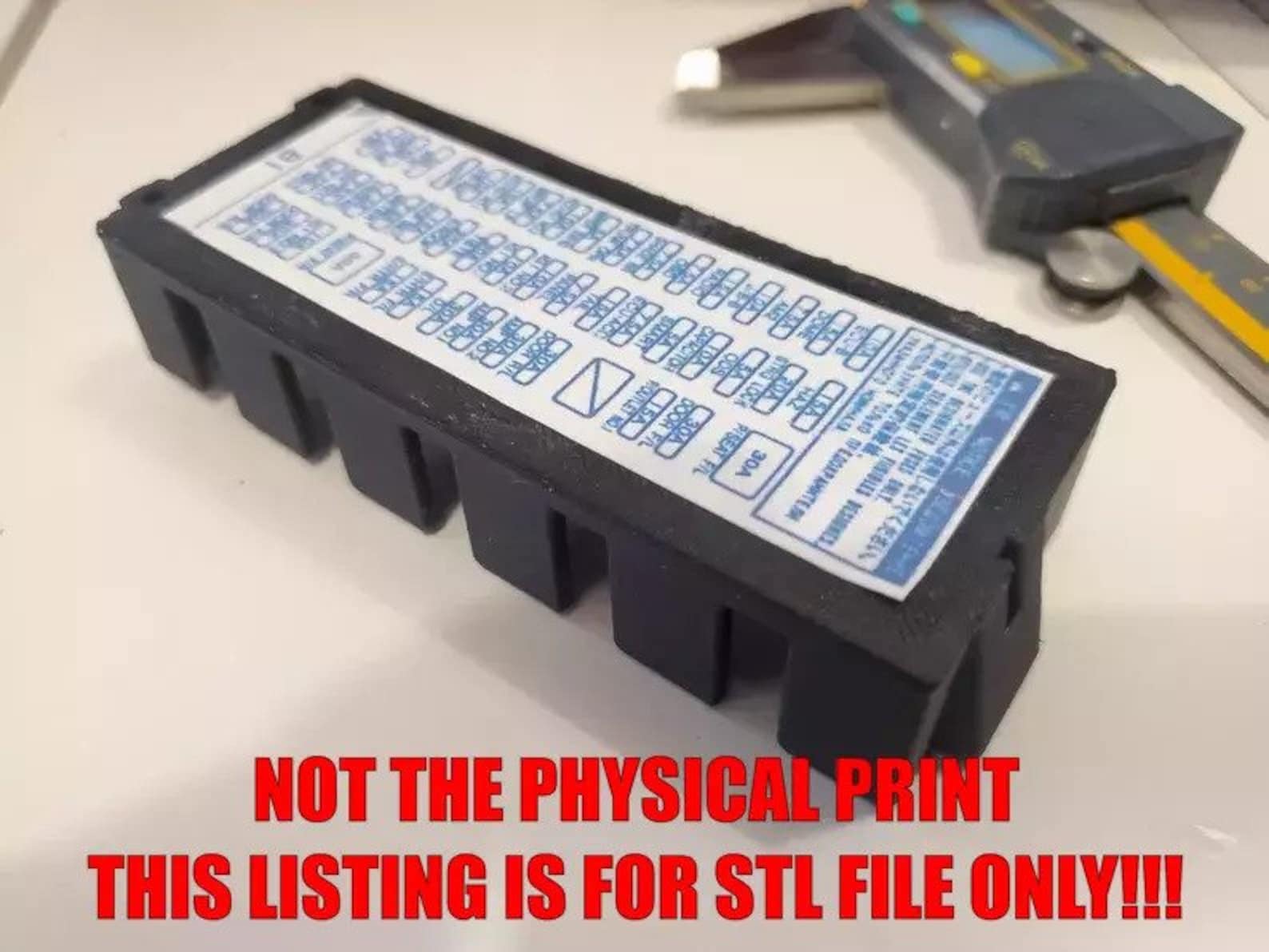

His V2 reuses the original cover to actually store spare fuses in the cover itself. It's quite ingenious.
He does sell the V1 STL files on his Etsy page, but I really like the V2 better.
V1 for reference:
